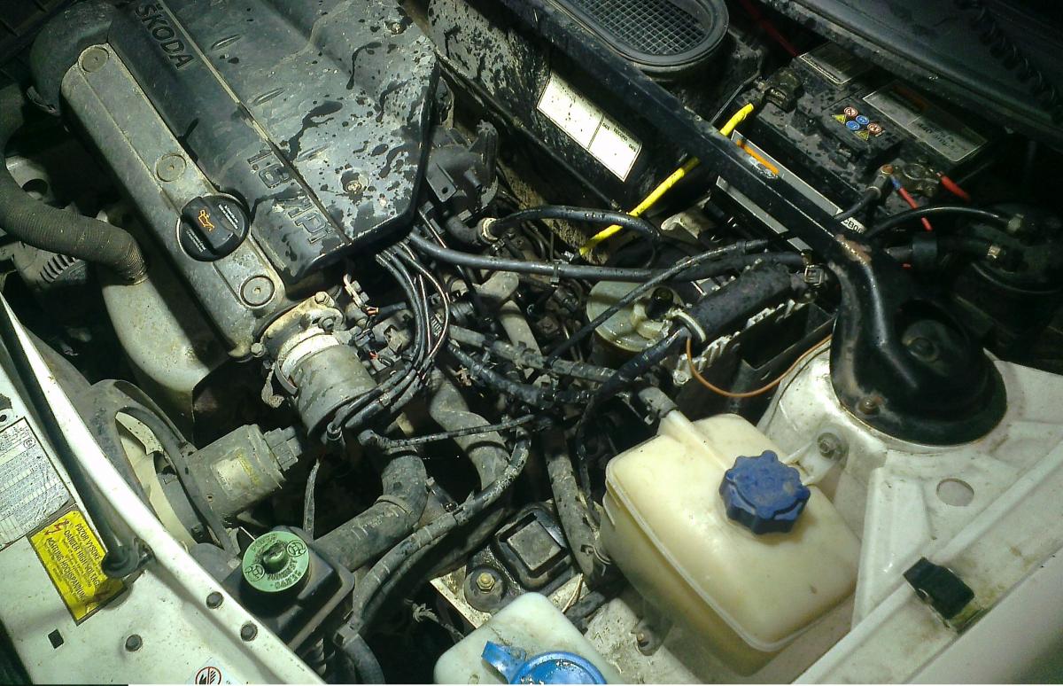

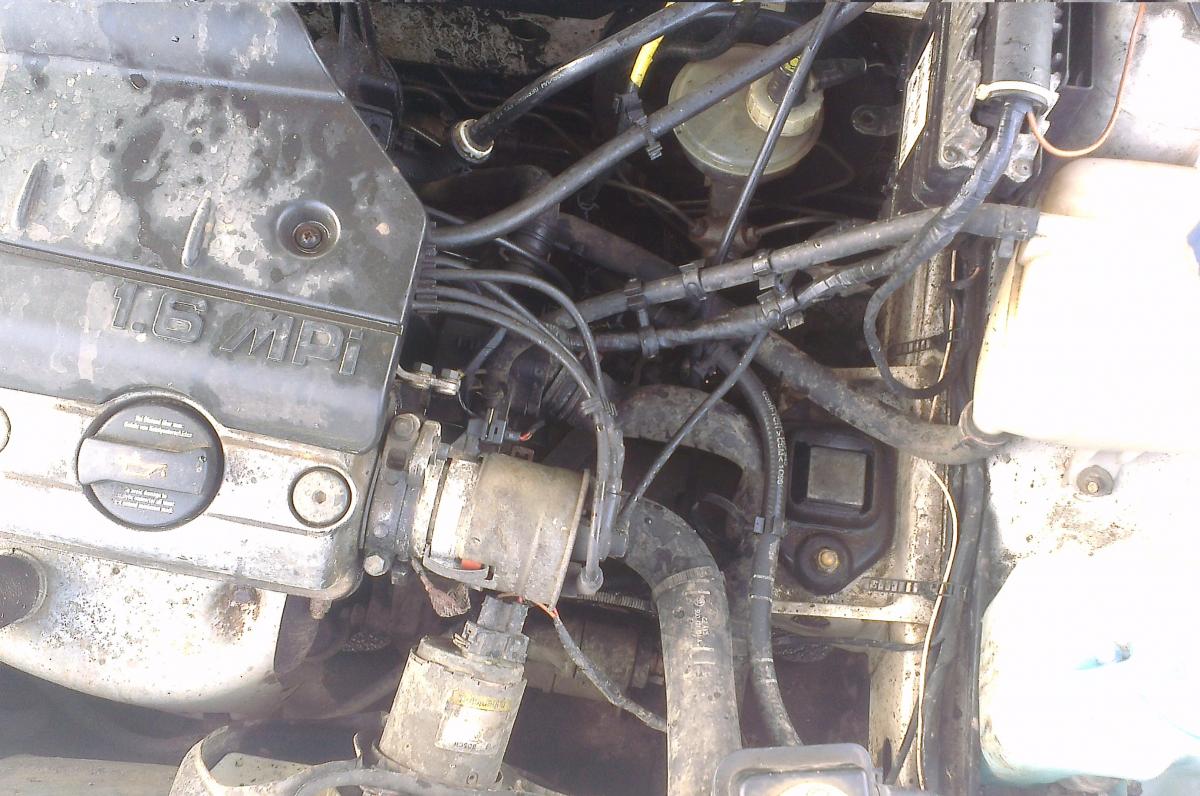

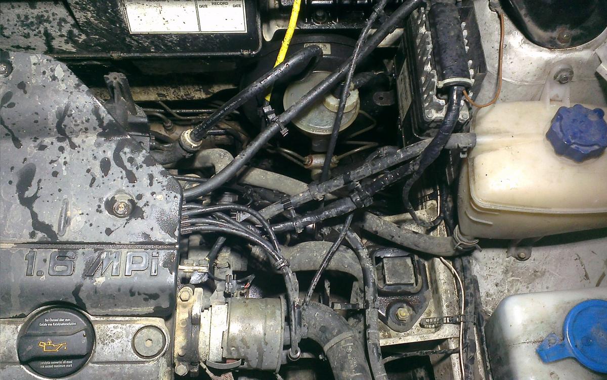

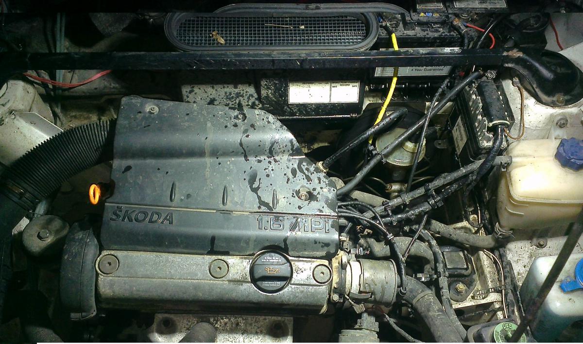

WOOOOOOPS!
Well this brought on my first ever DNF on a 12 car rally!!!! now what to do, I was toying with the idea of swapping it out for a 1300 gear box anyway for the final drive, I was thinking of buying a whole car from ebay for the gear box then Id have a few spare parts such as doors subframe suspension parts but does anybody need an engine or any other parts? or I buy a 1600 then iv got a spare engine to tune ( also on the to do list) then I can tune and drop in when done, ooooooh what to do?!?!?!?!
Does anybody have a 1300 gear box for sale?
I saw ths topic the other day and I was trying to work out what it is you've doge to the gearbox? Has the casting with the mounting broken?
Yup that's exactly what's happened. Has anyone else ever suffered with this do you know, was it a one off me being an animal or is it bit of a weak point? Im going to look at bracing it when I look at repairing this box (to keep as a spare and strengthen the new, I'd like to replace with a 1300 box am I right in thinking there a 4.1 final drive compared to the 3.something on the 1600?
I have seen a few break like that, usually a poor casting, it is a 15 min fix tho as the mount is on the gearbox end cover so just bolts on. If you know a good welder that does alloy they may be able to weld it up stronger but every welder I.tried said it is poor alloy and it wouldn't weld very well
