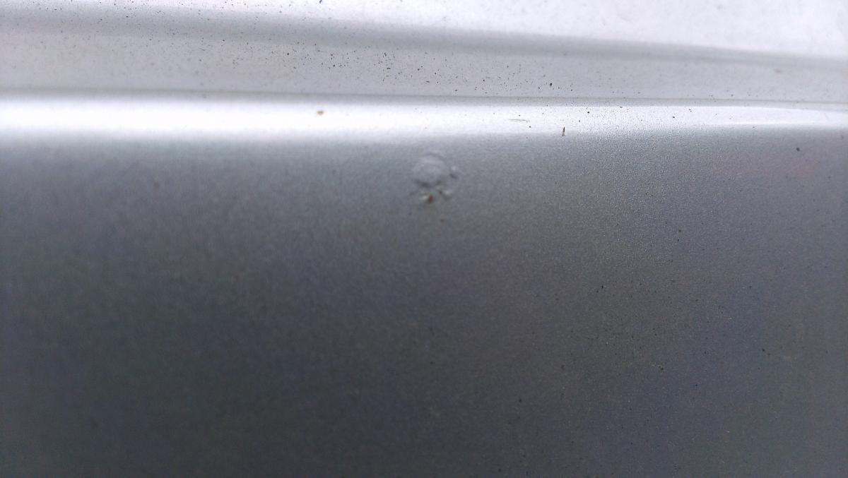

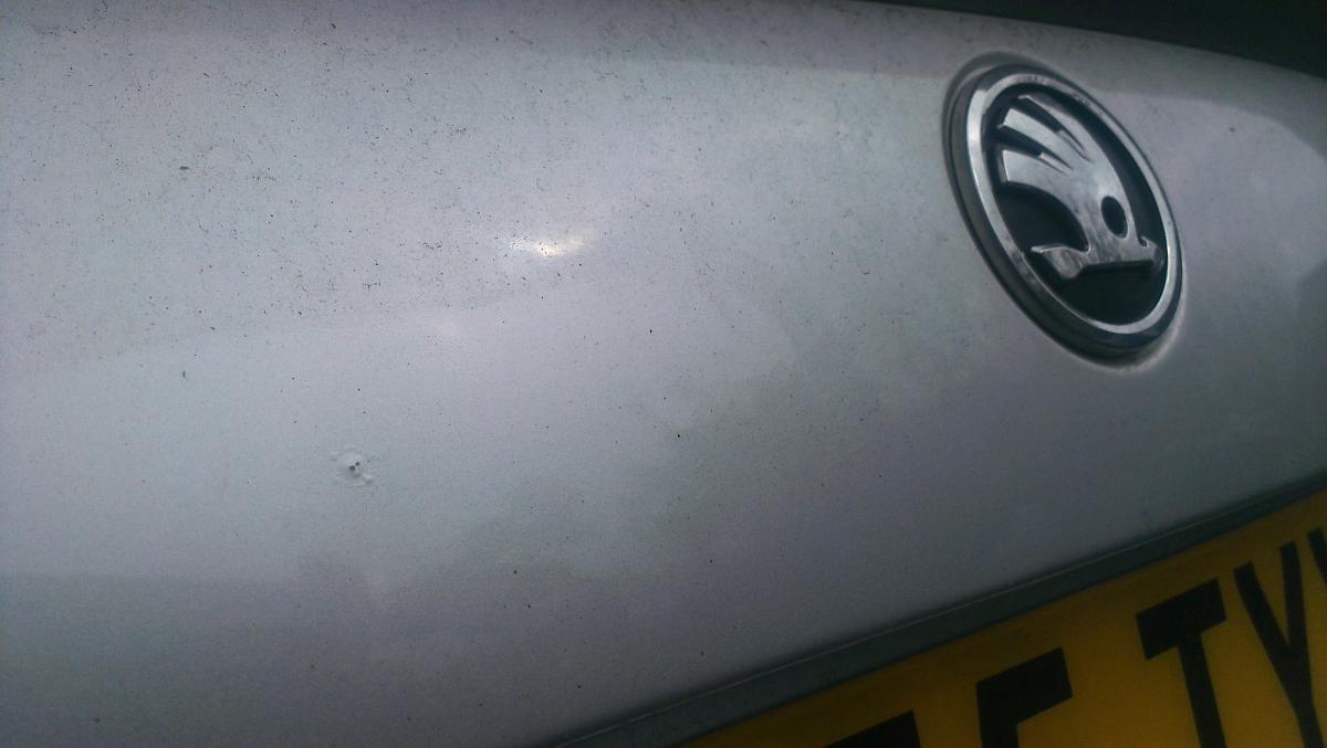

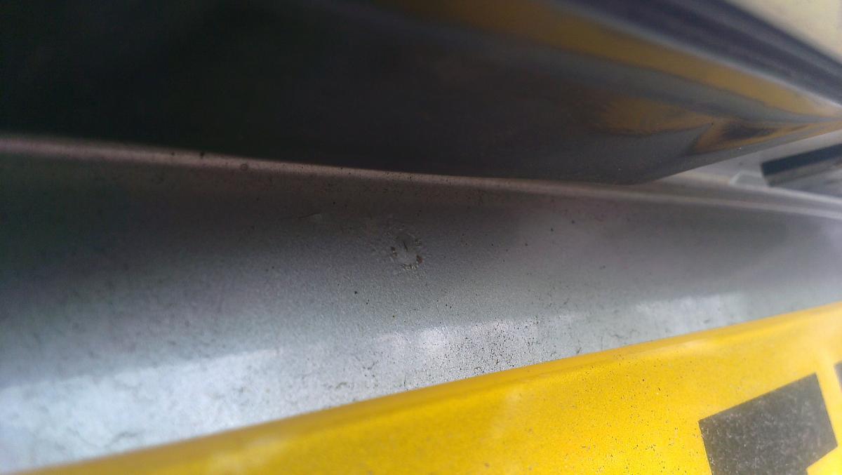

Some pics of the issue:

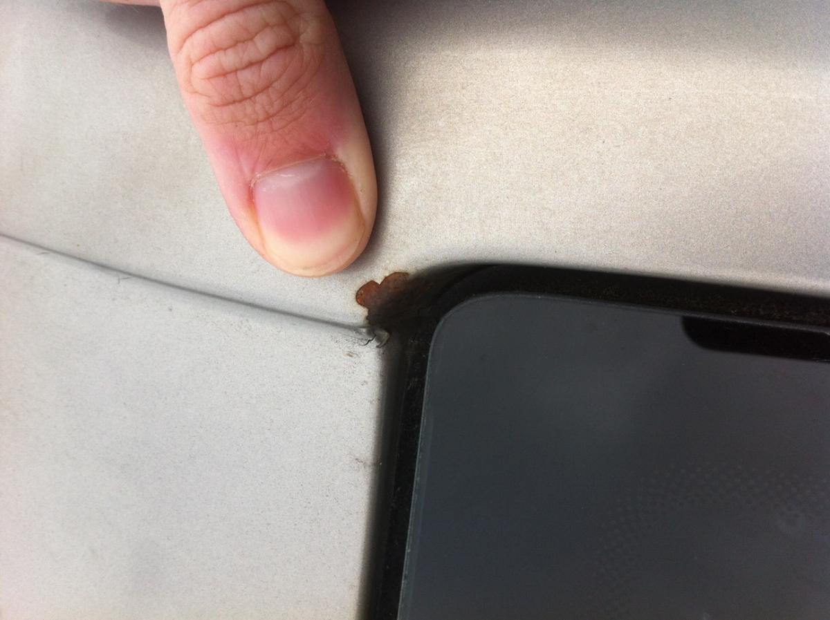

Anyways, The patches are getting worse (see pic below)

Not doing anything has made it worse.   Get to alfrauds or your local car spares shop and get yourself a touch up kit , follow the instructions and do it yourself, at least it will slow down the rust.
The leading edge of the roof is vulnerable on the Octavia as it sits above the rake of the windscreen so any stones can make contact with the paintwork on the roof.
Depending on how the new windscreen is sat (it can vary by a few millimeters) can sometimes expose even more of the leading edge.

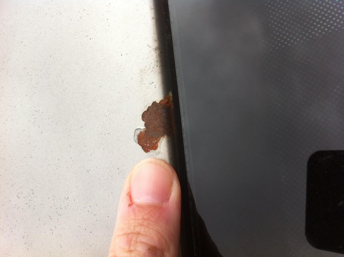

It may just be coincidence but i do know of a few people who have had new screens and a bit later rust has started to appear around the screen ! When they take them out if they are not careful they can scratch the inner sill where the screen sits so when the new one goes in you can not see the bare metal..... until the rust starts taking hold. I have never had a new screen but if i needed one then when the old unit is out i would be cleaing out the surround and looking to ensure all the paint was untouched by the tools he used.
