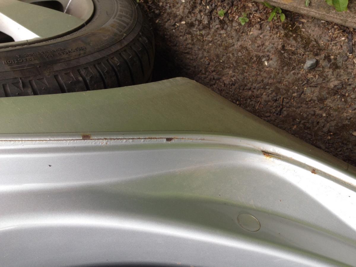

Since January when I took my Octavia (2007 pre-FL) to the dealer with rapidly rusting sills (they had gone from one stone chip on the NS to lots of rust on both sides since October 2013) who then tried to fob me off with various stories & excuses about how the sills had been repaired previously and had been cut off and replaced.
To cut a long story short, SUK have asked me to take the car in to the dealer to be photographed on the 14th May, so I need some ammunition before then please.
I've been to two body shops, one was the Skoda authorised repaired in this area, and both say the car has not, in their professional opinion, been previously repaired. This is contrary to the dealer, hence the contact with SUK.

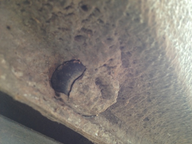

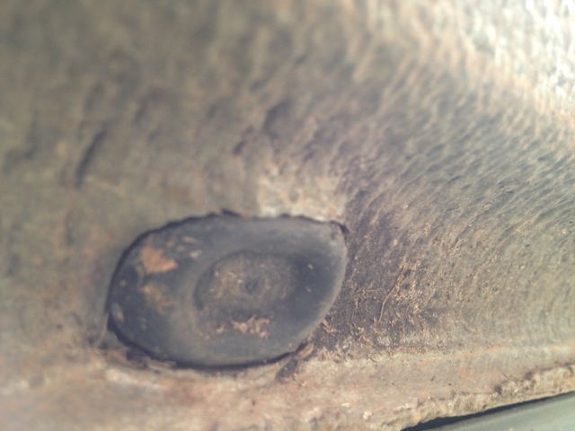

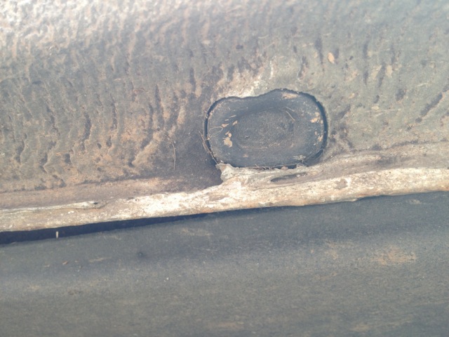

One thing they will argue over is the state of the rubber bungs (drain bungs?) on the bottom of the sills. They say that the bungs should not be squished or have the underbody protectant over the top of any of them as that is not how they would have left the factory.
These are some of mine:
post-59543-0-91210700-1398872275_thumb.jpg  post-59543-0-94116300-1398872293_thumb.jpg  post-59543-0-44245300-1398872319_thumb.jpg  post-59543-0-67549200-1398872340_thumb.jpg
Would any of you with Octavias from about 2007 be kind enough to take some pictures of yours and post them here for me?

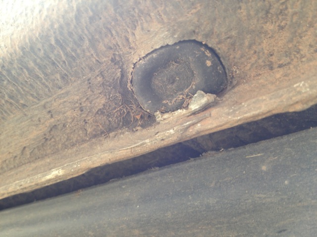

  • I think this settles it.   Here is one of my rubber bungs (through the muck):       As you can see they are completely covered. They all are on both sides.   I think they are meant to be c
  • The bungs are fitted then the underseal is sprayed over them, skip to 6:30 on this video

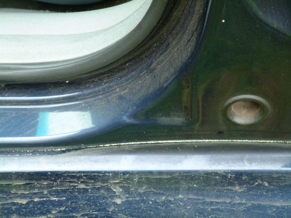

Can we we your pictures?
Ours is a '57 plate with 35,000 miles on the clock.
Will get a couple of pictures for you later.
Phil
You can now...
I had an issue with uploading them, so saved the thread and added the pictures straight after.
shocking skoda paint shop quality strikes again, my opinion is has been like that since it left the forecourt, maybe it was a bodged pre delivery repair or similar? That textured stone guard has started to lift where the moisture has got trapped in there, it's probably because no primer was used on the panel or it was poorly prepped, it's quite common for skoda to omit to prime panels to save a few quid, I wouldn't be surprised if that entire outer sill panel was crusty with rust where the water was collected inside too. Hope you get that sorted soon, that surface rust in the lower lip in the second picture will steadily get worse over time until there is holes in it.
I've started to see this a lot more commonly with it happening on works vans from 56 plate right to 12 plate ones as the paint quality seems to be poor!

I certainly think that my sills are rusting from the inside as it all started with one small (maybe) stone chip on the NS and has escalated to lots of flaking paint on both sides quite quickly.
The brown in the pictures may just be dust as we seem to have quite a lot of dry mud on the lanes around here at the moment.

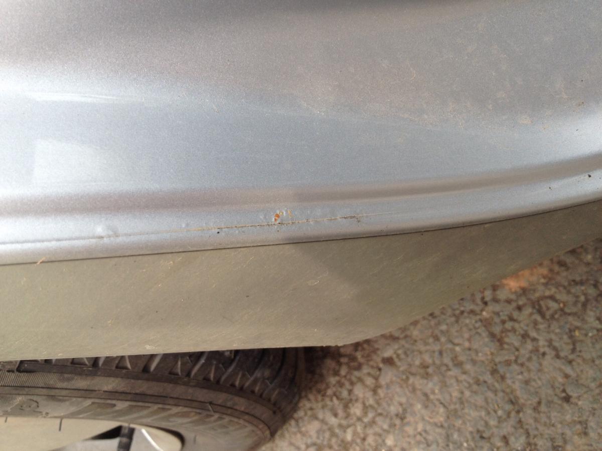

Here's another issue they are going to argue over.
These are the rear door shuts looking towards the rear wheels.
The dealer says that these lines, where the rust is or is blistering, show where new sills were grafted on to the car following a repair.
Both body shops say no to that. You just wouldn't do it that way.
One pointed out (I told the other) that the lines exactly match the rubber deals on the doors... This suggests???
I think they are meant to be covered and yours have come uncovered.
Like I say this is a 57 plate with 35,000 on the clock.
Phil
Edited by Phil-E
Thank you Phil.
Begs the question as to why the dealer told me the sills would be coated first then the rubber bungs put in?
And why have all bar one of mine come uncovered completely?
This is exactly what happens when the seals start to go or the door is misaligned.
The golden rule for warranty work is the rust has to be from the inside to out. One thing that commonly happens is the sills get squashed and are repaired. They don't usually get cut off. The seam is often split and the sill is reshaped. From what I can see of the seam, I can't see a gap.
Thanks for that info. Can you clarify what you mean by 'when the deals start to go'?
There's no sign of any gaps or misaligned seams that I can see although the dealer did point out a slight twist at the front jacking point.
As far as I can see though both sides are the same or as near as.

My rust spots are all above the stone chip paint, nothing below. I've been trying to stay on top of it myself but it's a Sisyphean task.
They're all in the front half of the sills.
