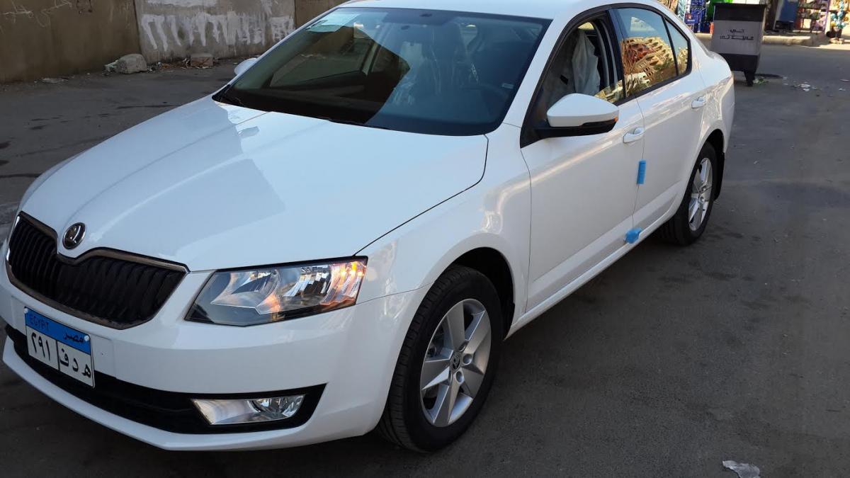

i just moved from a Honda Civic 8th Gen (2007 model) sedan Jap version & not the US or Eur. version, to a new Octavia 2014 1.4TSI DSG ambition,
i have till now 2 problems that needed your great help with if you can , and a question,
1-the outside noises insulation of the car is really not good & not as i expected and i don't know why or what is the problem ,at speeds the wind sound is very audible & even when parked and just siting inside the car with all windows up i can hear nearly everything on the road like moving cars & people talking ect...
it is like when you are parked & people move beside you while taking you hear them as if there is a window open & by nature i put my fingers on the 4 window buttons to check they are all closed
and while driving if a truck go past you or motorcycle or something i always feel the windows are not closed , while they are all closed properly
2-another strange issue that i wasn't expecting from such fine car is handling in the cross winds , at speeds like 120 to 160 KMs with side winds in the road the car just feels sliding on the road left & right and the steering always needs adjusting , the cars feels very very light when there is side winds and i don't know how to improve this if there is any way,is there any possible way to make the steering stiffer? and if there is a way , is this gonna help with the cross wind effect??
last thing that i needed to ask you about is the suspension stiffness , my car now is just 3650KMs on the clock , but from day one the suspension is very hard on potholes and such and even makes so PULSE sounds especially from the rear suspension , so is that normal?
thanks in advance for any help :) :)
(note : if you can notice from the pic attached , the octavias we have here in Egypt have higher Ground clearance that in Europe)

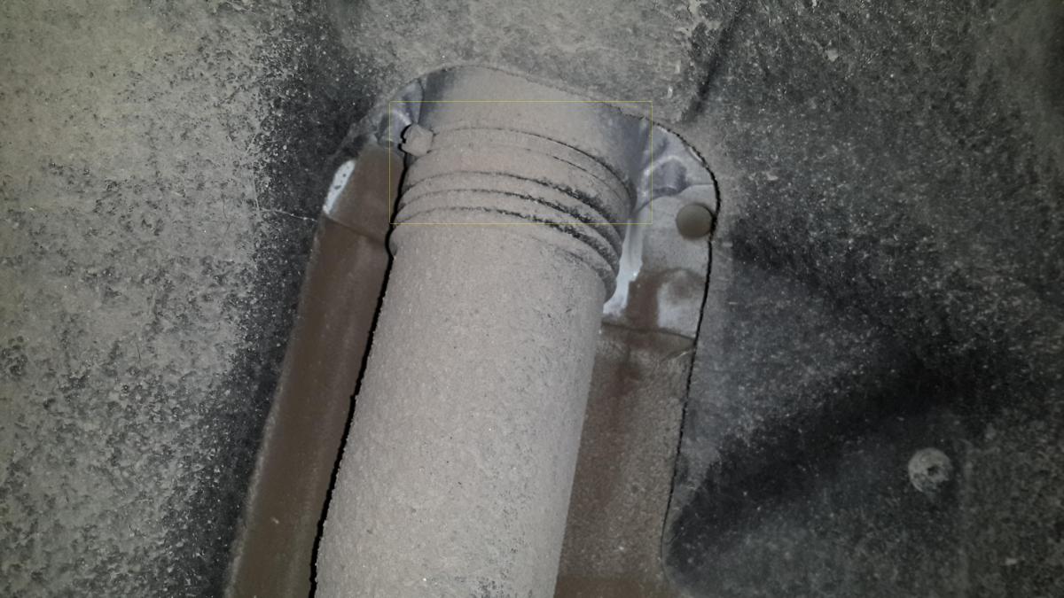

could you plz check the attached pic & tell me what is this small belt in the top of the shock absorber?????!!!
Hi Mohamad,
The cable tie at the top of the shock is normal.  I just checked my car and I have them too.  It looks like it's just there to hold the shroud in place (keeps muck and dust away from the moving parts on the shocker).
