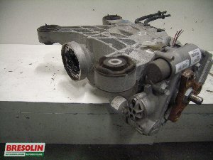

Sorry for late replay, just bought skoda yeti with never replaced haldex filter. It exist and  is same like on vw tiguan. On picture is on right down corner fixed with 2 screws. I have yeti 2012. 190000 km. Never changed. Have to do it. About 50$ price..
