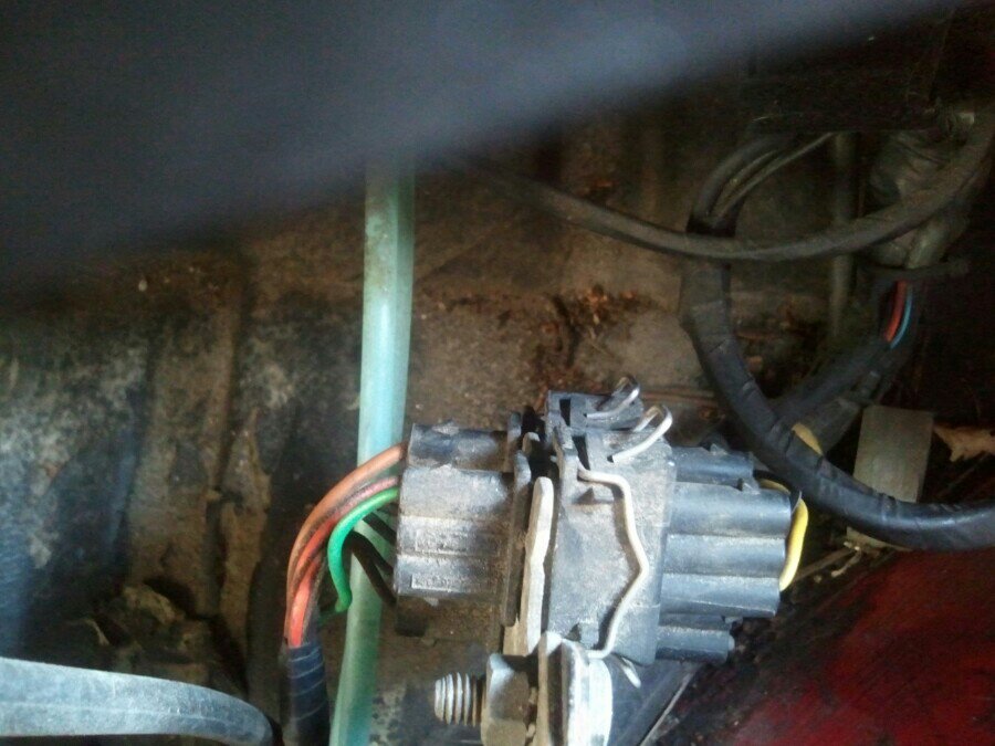

Anyway I wanted to try your suggestion anyway but Im not 100% sure what part you talk about. So I have taken a picture...
http://imgur.com/EzW17BN
Is it the connectors behind this?
Yes that the connectors, you can see the yellow wire there too, even with the connector unplugged you can still connect to the immo box...
I see the yellow wire but i don't think the is connection to it on the other socket.
Here is a close up picture I took..
Sendt fra min GT-N7105 med Tapatalk
Yeah sorry I'm being a div, the yellow wire is for the abs (if fitted) just realised I'd made a mistake when I was thinking about it earlier.
The so called 'K' wire is one of data transfer wires and runs from the 16-pin diagnostic socket to ECU. As mentioned it is not related with the immobilizer issue.
What TeflonTom meant is the so called 'W' wire (black/gray) that runs from pin 2 of the immobilizer to the above mentioned 3-wire connector, pin 1. It then goes as a green wire to ECU (pin 19 of the 52-pins socket). It is a valid point considering to check that circuit for good contact. In fact, if I were you, I would WD40 spray the entire ECU socket and the 3-pins one.
