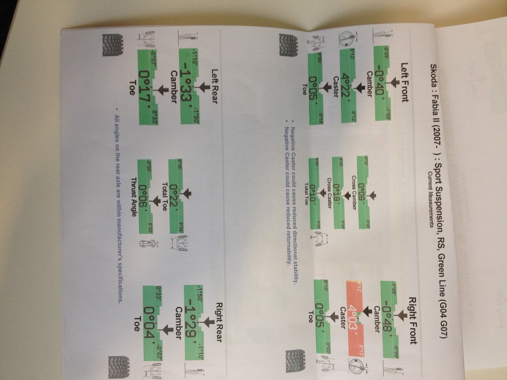

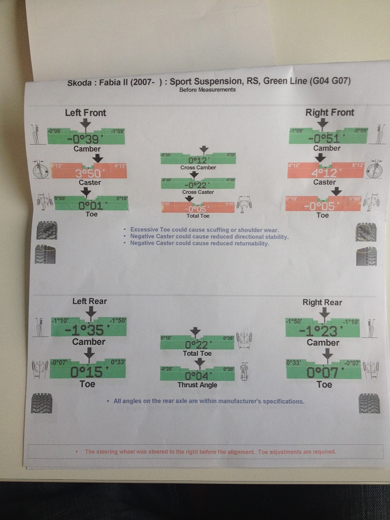

EDIT: I have attached the before and after alignments for you to see how much better they are. The important bit is the caster.

Could my issue be related to tyre balancing?
This website says that it could have a bearing on pulling to one side.
http://www.balancemycar.co.uk/pull-issues/
I would have thought if it was then moving the wheels around would change the direction of pull.
Also I guess the structure of the sidewall is what is different between the Dunlop tyres and other makes, hence why the issue is reduced when you swap out the Dunlops.
Edited by marky
