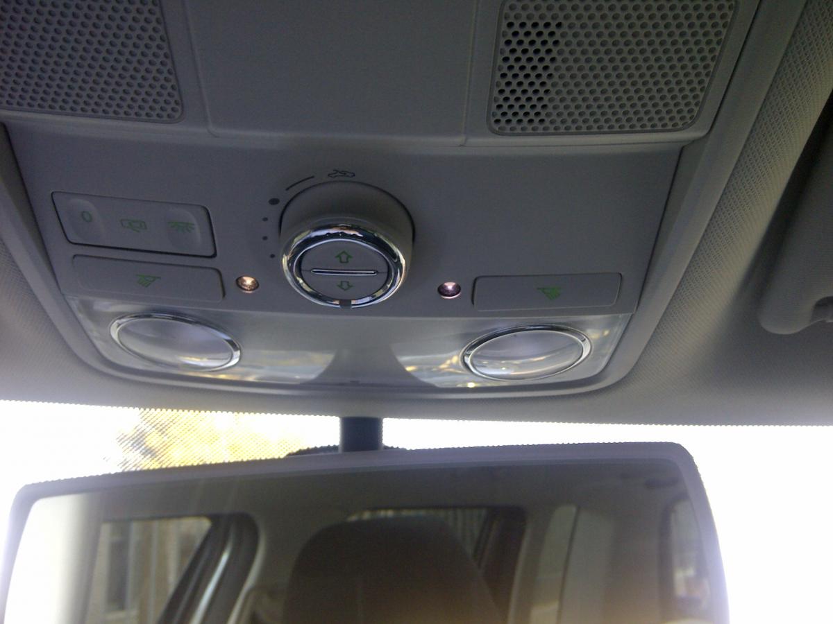

Here you go!
I have confirmed that the "cat's eyes" only come on when the headlights are on (at least in dipped beam, will have to check if this also works with just the sidelights on).

I do not have a rain sensor or a dipping mirror fitted, but I do have the auto lights. Not sure how that affects mirror positioning compared to the other options.
Unfortunately it was already quite bright in the morning so I could not take a picture of where the lights shine on, but I can confirm that they illuminate the area just ahead of the gearlever.
That makes more sense are tour cats eyes are further back from the mirror than our UK lights.

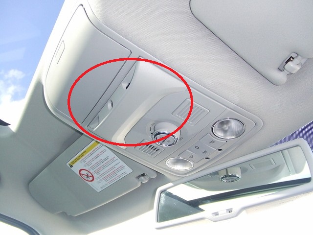

Looking at this picture and comparing it with my own, it looks like the difference does indeed have to do with the auto-dipping mirror. I am guessing that the cluster behind the sunroof knob in the picture above contains the sensors for this, which seems to be what forces the cat's eyes to be fitted further forward. As previously mentioned, my Yeti does not have this but does have the pano roof fitted, and the cat's eyes are fitted further back - and are fully functional.
On my Superb all the auto dimming is actually in the mirror itself, I would imagine the Yeti is the same.
IMO it is probably just a bad miss match of VAG parts meaning they are disabled, if they fitted the light unit with the LED's further from the mirror then they would I imagine be fine.
Interesting... Then what does the cluster (marked in red) do? I thought those were the sensors for the auto-dipping mirror...
These are the alarm interior sensors and the mic for phone connection.
The sensors for the dipping mirror are the 2 small oblongs in the bulge on the bottom of the mirror.
The 3 round sensors at the rear of the roof unit are the volumetic sensors for the alarm and the phone mike.
The sensor is in the bottom of the mirror.
The microphone for the Bluetooth is in the vented panel next to the sunroof knob.
Here you go!
You don't have an alarm fitted with interior monitoring...  that is why you have the LED lights.  In the UK an alarm is standard fitment and hence we don't get the LEDs.
