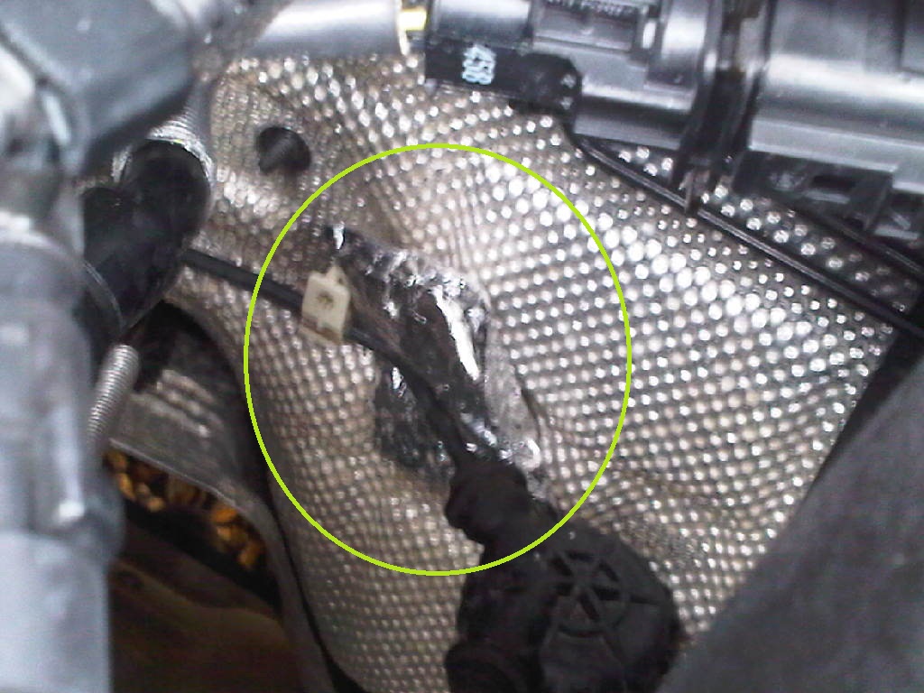

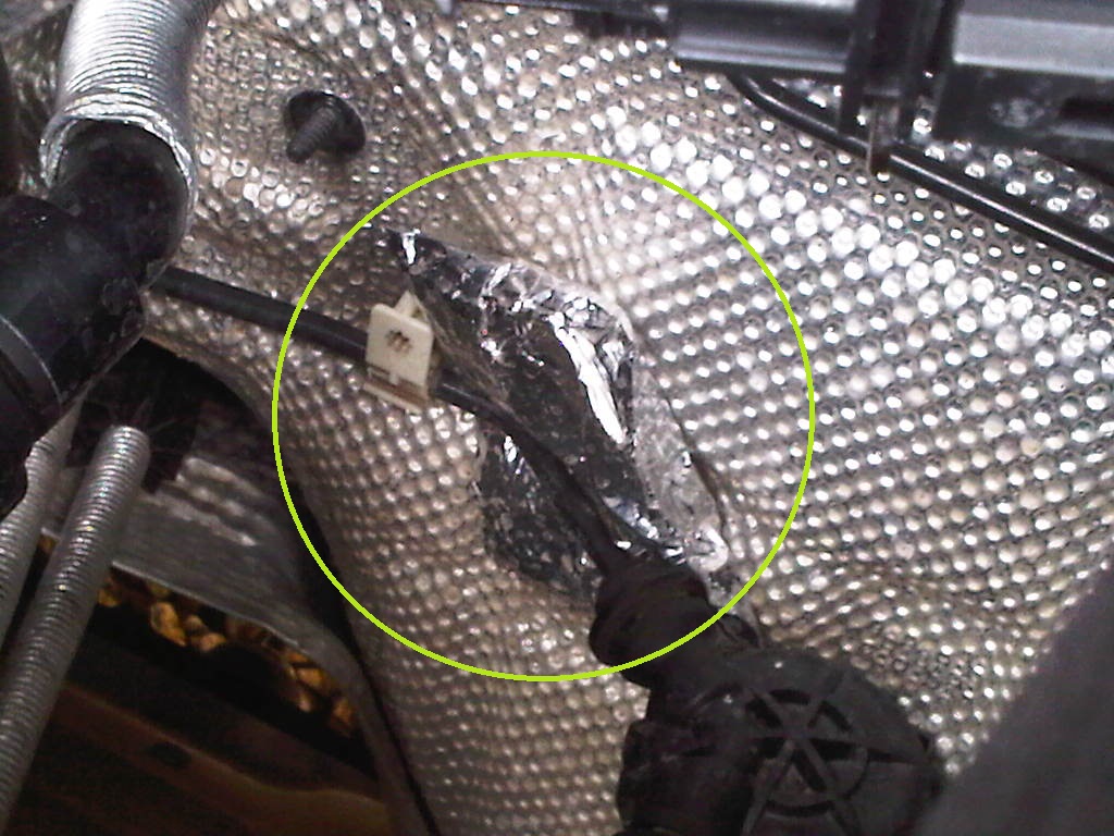

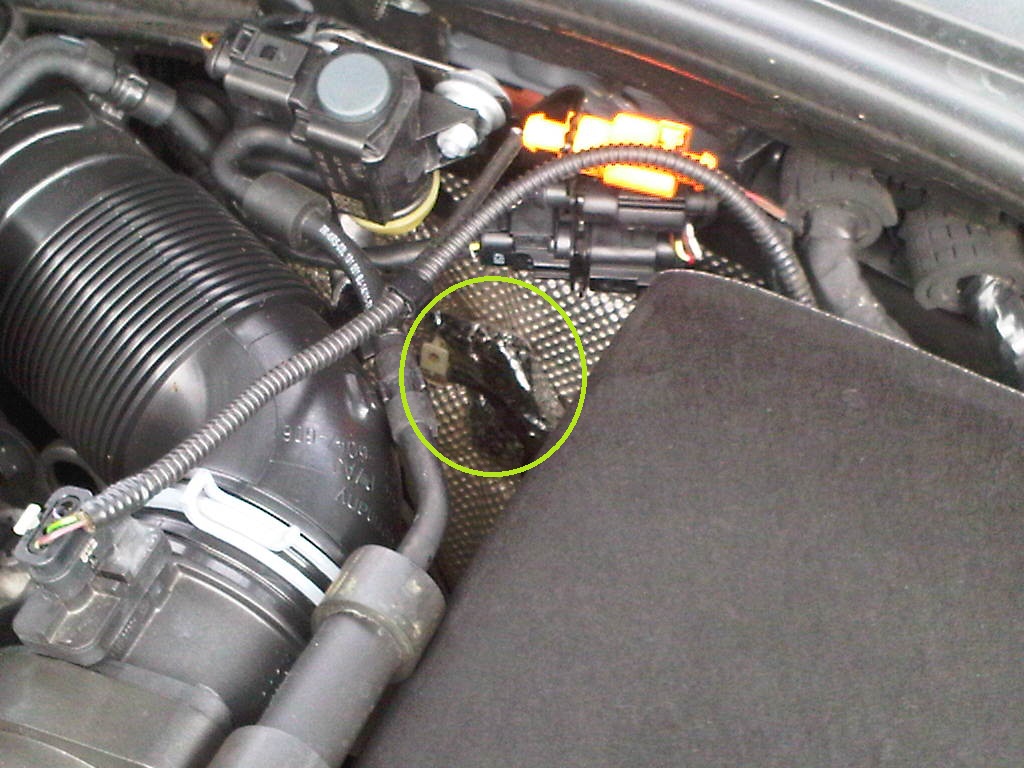

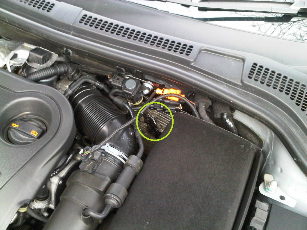

Sorry, hadn't read your first post correctly.  The heat shield rattle is also a known issue.  There is a pipe that sits close to the heat shield at the bulk head.  The pipe has a white plastic foot on it facing the bulkhead.  I wrapped some insulating material in aluminium tape and wedged it in between the plastic foot attached to the pipe, and the bulk head.
Here you go - this is the fix in pictures.
Thanks thats the area I think its coming from, I was thinking of the same and had a quick look earlier, looks like not much room for my big hands so maybe a struggle lol.
No probs.  Just make sure the engine is cold when you do it!  If you tap the heat shield, you'll get the metallic rasp.  Hopefully it's the same noise that you're experiencing.
