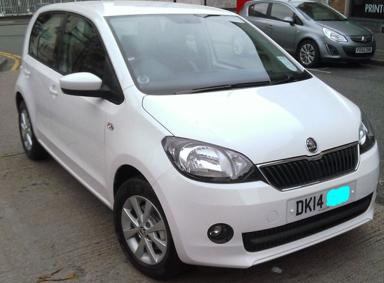

We are looking at picking up our Citigo next week and as its in white I think the silver alloys look a bit bland (personal view).
I don't fancy doing any other mods externally (i.e decals, skirts, spoilers, etc) but I'd love to get the wheels painted black.
Saw this pic on Autotrader and this is the look I'd like to go for...

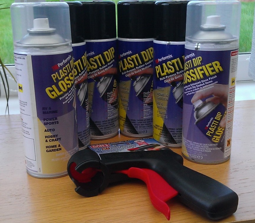

Mort1, I've decided to go with the Plastidip for the wheels. How many 400ml aerosol cans do u think I would need. Plan to apply about four coats and two coats of the aerosol glossifier. Considering the wheels are 14" in size how about 4 + 2 cans?

Thats plenty enough. I guess 5-6 layers i fine.

Thx all. Cans of Plastidip ordered so aslong we get the car next Saturday and the cans arrive then I'll give it a go on Sunday and take some pics of my project.

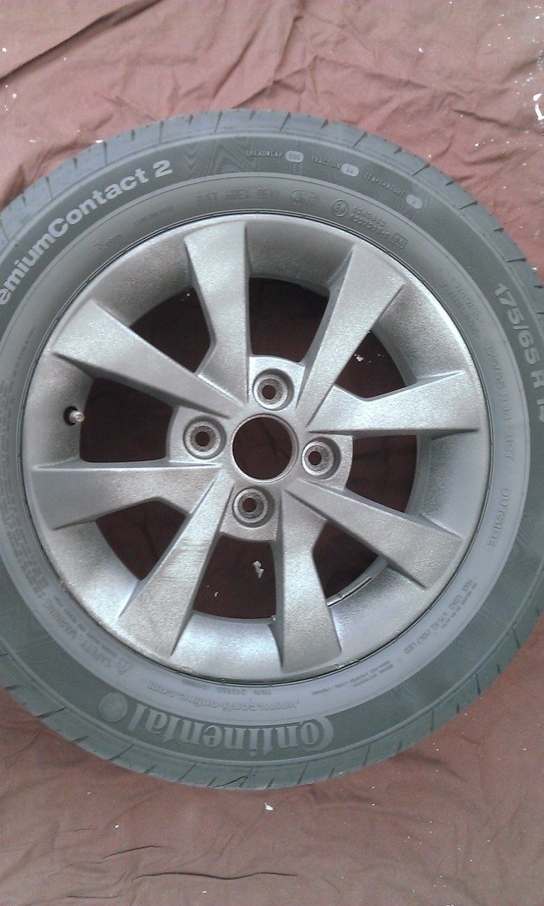

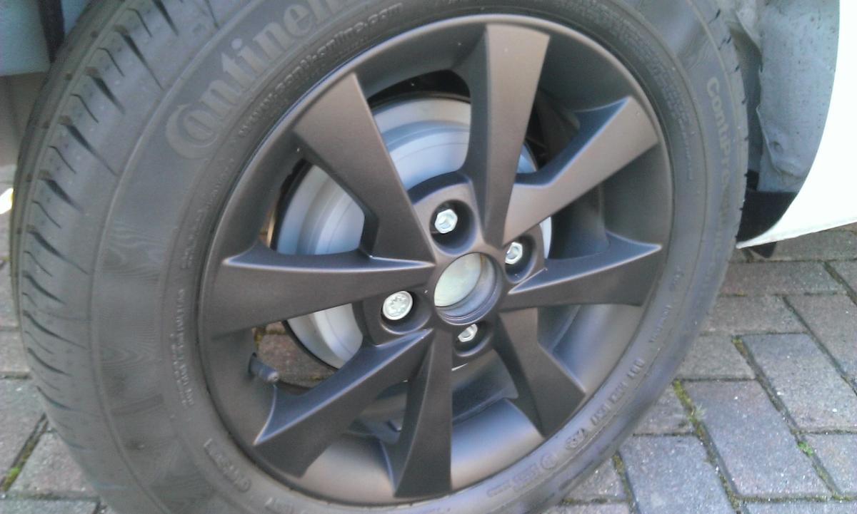

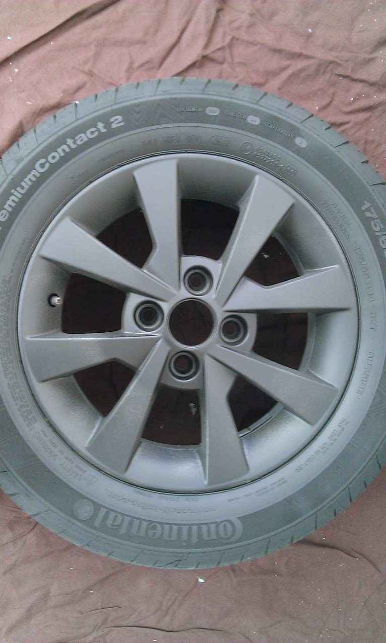

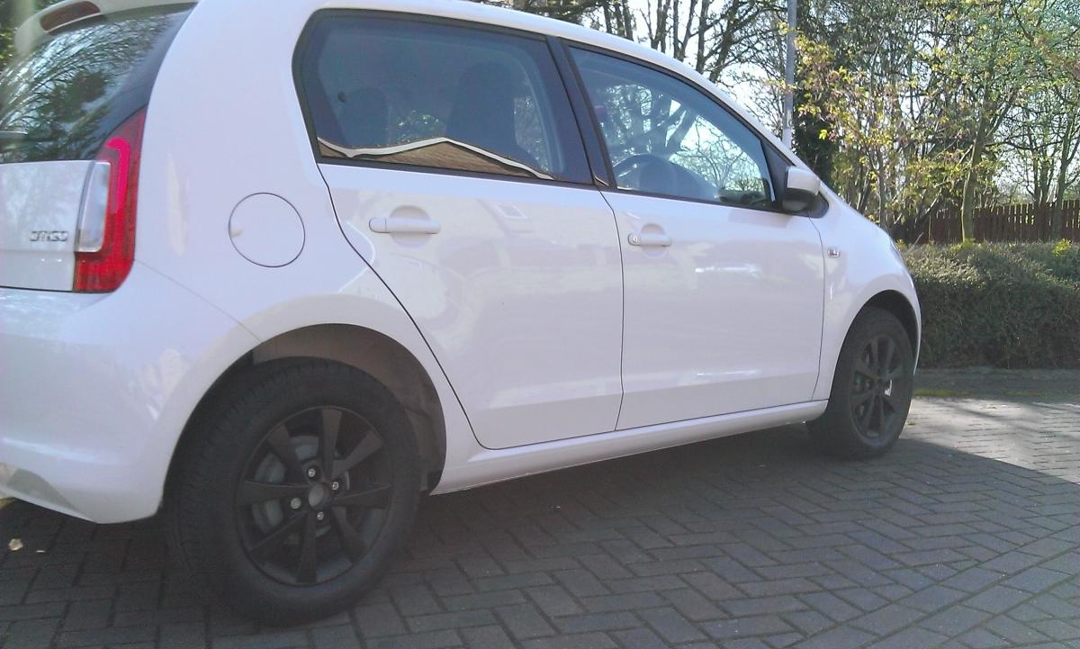

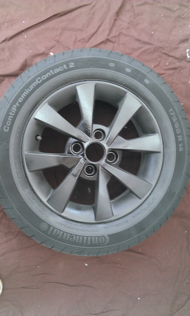

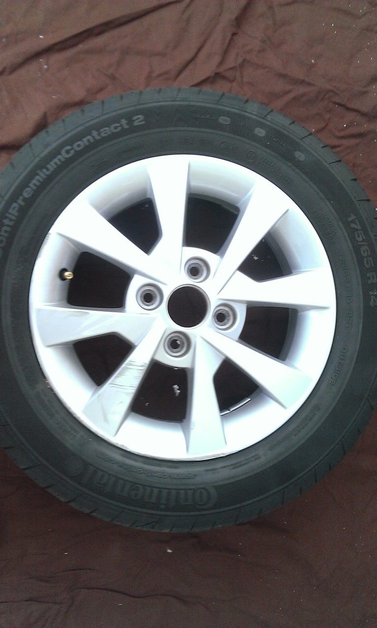

Here are some pics of what I was up to yesterday. A special thanks to Mort1 for suggesting the idea and I have to say as novice this was very easy to do.
A full write to follow later...
Top work
make me want to do the ones on the Fabia or Ibiza now.
what colour goes with a black car :D
what was thetotal cost? (if you don't mind sharing)
any before pictures of the car so that we can compare and contrast
ouch - official plastidip clearly carries a premium
still considerably cheaper than a respray or powdercoat for a pretty dramatic change
Nice one Z
looks way better :thumbup:
Top work :)
Great job! Looks really good :)
Did you feel the need to use all of the Dip and Glossyfier?
For the five wheels I ended up using 3 cans of Dip and 1 can of Gloss
