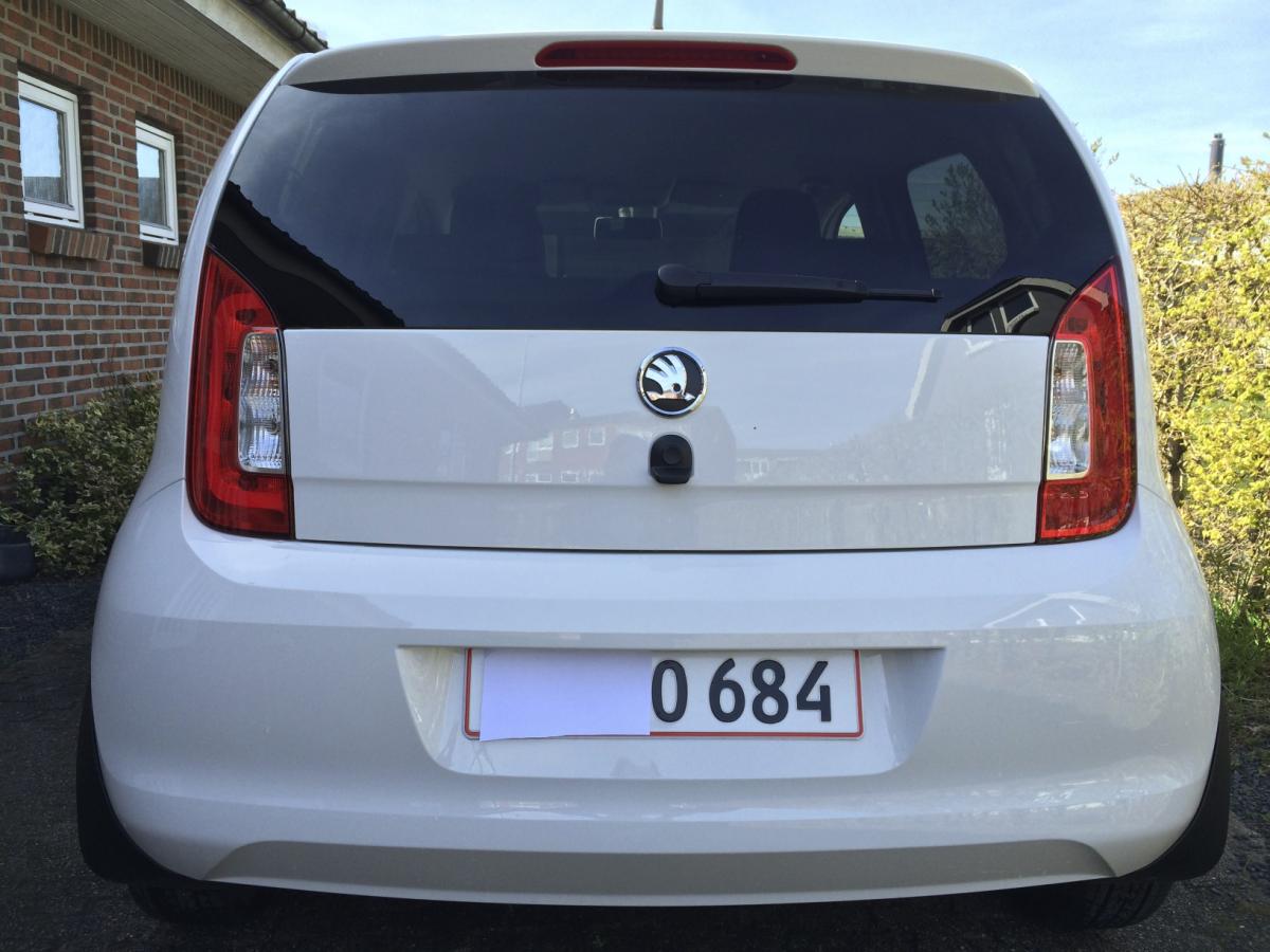

BECAUSE OF THIS TREAD I DID IT TOO !!!!!!!!!!!
And absolutly love it, it made my car look more "clean" and it actually looks more wide from behind...well thats just my opinion ;-)
Thanks for all the info on how to do it, I did use the hairdryer for the first letter but didn't have the patience and just "flossed" the **** out of it, witch was very easy...the sticky stuff under the letters was not that easy to get of, but tar remover did the job ;-)
