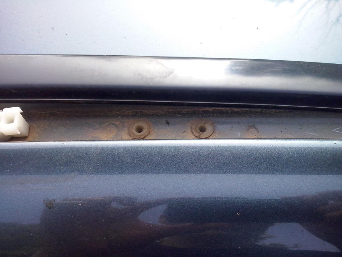

So it's possible to buy the guttering without the holes cut in ? I had the roof rails on but took them off as I don't like the look of them on I will take a pic of how the holes are on mine

All depends where you are Mike I will go take a picture now of what I have been left with

70B76519-50E5-461E-9E8C-3291D35D86A1_zps
7B88EE56-9157-4CAE-8BB2-31BBD2361A6B_zps
0CB9D0CB-BA66-4C3D-9AFB-9753CCF2F16F_zps
Thanks for the piccies.
Regards, Mike
