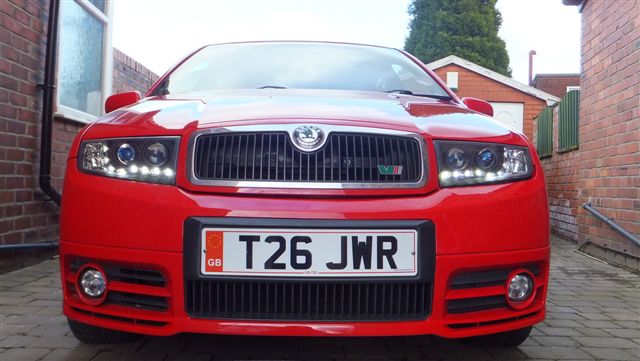

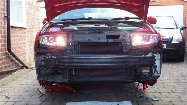

Mk1 fabia devil eye headlights sometimes described as audi r8 headlights.
I was in the same boat and had seen too many led strip and thought they look hidiously cheap and tacky.
so i set out to find something that looked like they were ment to be there.
The DRLs are actualy the side lights, they are a direct fit.
The only tricky thing with them is the hight adjusting motors have to be turned 180 degrees to fit this then reverses the controls in the car 0 becomes the lowest and 3 becomes the highest. Standard lights 0 is the highest and 3 is the lowest.

I have to say I agree with polo man. They're barely passable on the majority of new cars designed to have them, slapping them on a 10 year old Skoda isn't going to work IMO
Adding LED strips to any car looks sh*te, they just don't suit. I've seen Red Fox's lights in person and they look sweet! I would most definitely pay the extra buck instead of putting strips on.
