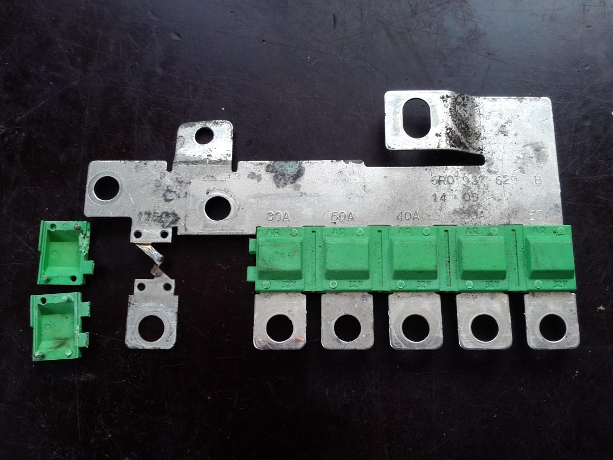

Ah! Solved the problem. The fusible link blew on the 'battery top' fuses. Hope this may be useful to someone...
Photo attached of blown fusible link. N.B. you can't see it's blown as the weak strip is inside the green plastic covers. A bit silly as you need a meter to check the link (fuse) or break green cover open.
Also a bit silly is that you have to buy the whole component shown if one fuse blows. Fabia1 has individual 'dogbone' fusible links which cost pence rather than the one here which was £16!
