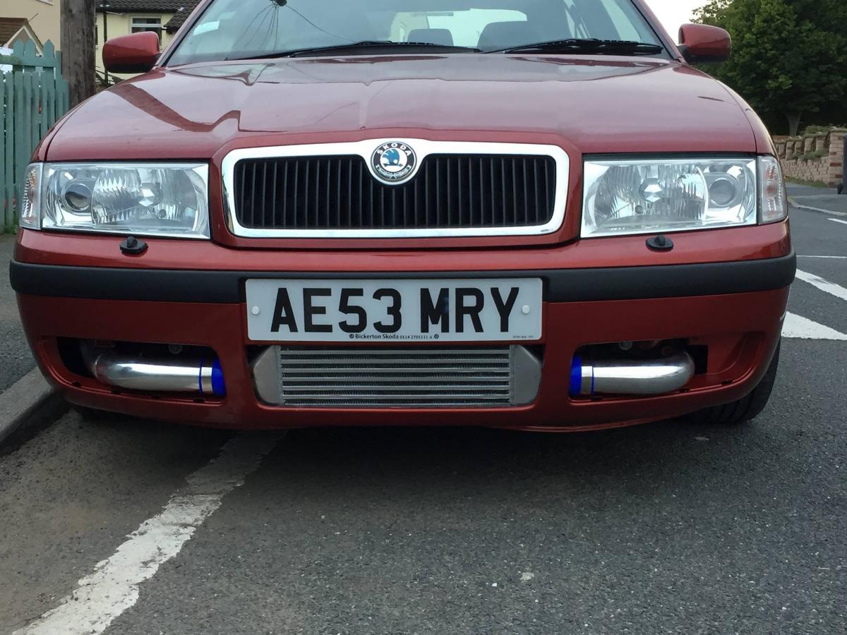

I have the same kit. The ends of the pipes are not beaded, therefore under full boost my intercooler pipes pop off, my car is on a stage 2. So before fitting I would advise to get the ends beaded :-)
Do you happen to know how it holds up at stage one?
It doesn't matter, under boost, it'll pop off. There was another thread on here yesterday that had an eBay link fit a tool to bead the ends. Looked very good.
every toyo kit ive had was beaded? which one did you buy?
I bought the toyosport kit that's named under the Octavia vrs kit. Under stage 1 the pipes still popped off. That link on eBay to that beading kit, I bought that, got delivered today, looks very good. Getting pipes beaded on Tuesday :-)
Ps I'm located in Birmingham and the garage I use can fit your fmic and bead it also with the kit I bought :-)

I have this one:
http://www.ebay.co.uk/itm/DIRENZA-VW-GOLF-MK4-1-8T-GTI-OFFSIDE-INLET-OUTLET-FRONT-MOUNT-INTERCOOLER-FMIC-/161249178899?fits=Car+Make%3AVW%7CModel%3AGolf%7CPlat_Gen%3AMK+IV%7CCars+Type%3A1.8+T+GTI&hash=item258b333513:g:hKUAAMXQPatTIwTx
no issue last 2 years. (price was 145 on auction)
Only mod that was needed is to remove bulk inside crash bar. 10-15 min and everything else was easier. according vag-com, IAT are 10° above ambient. So really pleased with result.

What pipes do you need to fit that?
I fitted the direnza one that's similar too the Toyo one no problems found since fitting it oh and make sure you allow a full weekend if it's your first time fitting one
it is all included. All U need to do is remove old IC, connect 2 pipes from kit and that is all.
Best thing is, it is plug and play, no mods (except that I already said) and that is all. Complete stealth.
Sounds perfect, cheers
