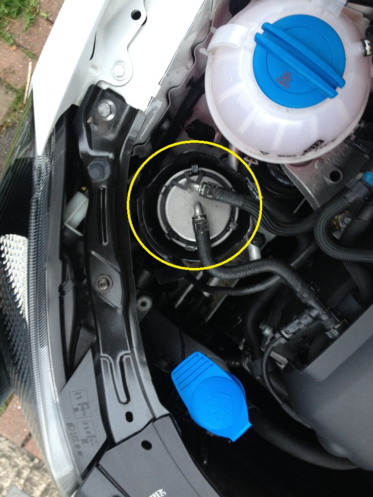

I can see the clips that remove the diesel filter but it's the housing thats in the way. Don't know if my car is different to others but the diesel filter is encased all around so you still can't get at the bulbs. See yellow highlight in attached picture
I tried three time last night to do the drivers side but have now given up. I don't have the necessary Torx (think it's a Spline) attachment for my socket/screwdriver set.

If that blue thing is your Washer Bottle Filler, then it's totally different under your bonnet to what's under mine, yes I know mines only a little 3 pot 1.2 Diesel, but still the ancillarys should be in similar positions!!
That explains it. They are different mine the 1.6. The blue one at the bottom is the washer bottle. The blue to the top is the coolant.

That blue thing is your coolant system, not the washer bootle...

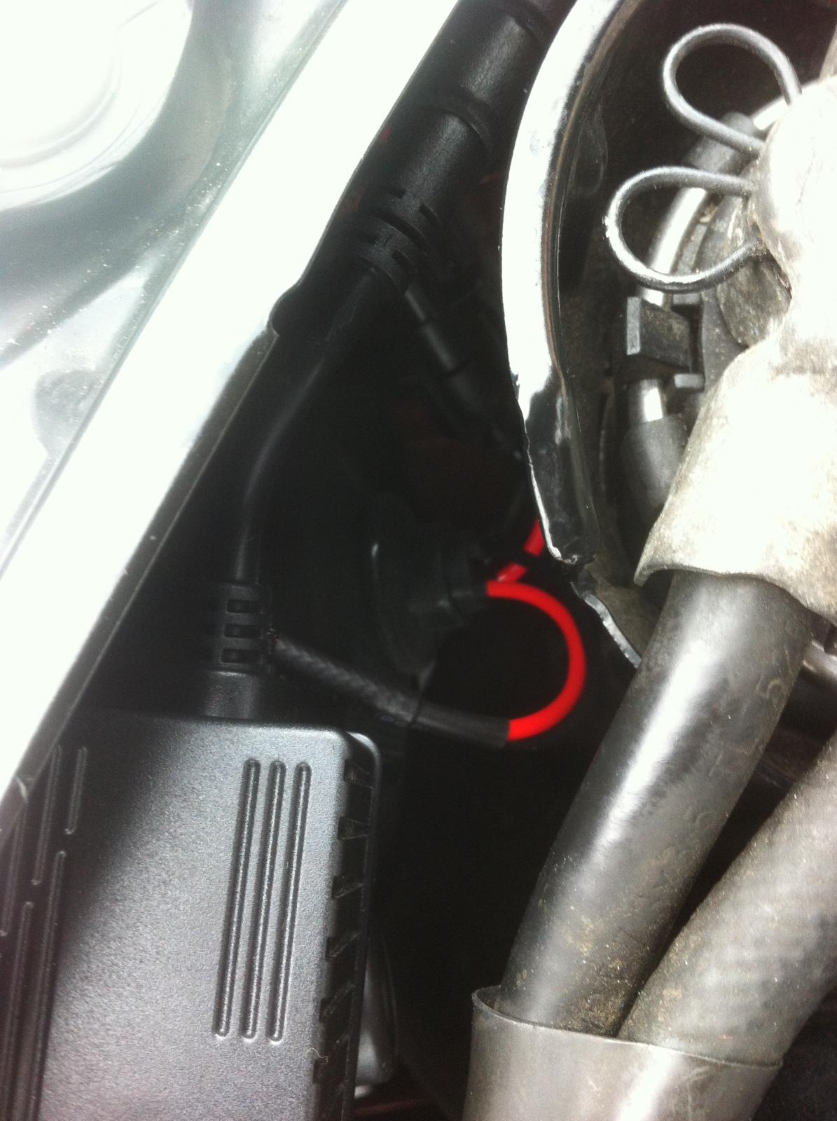

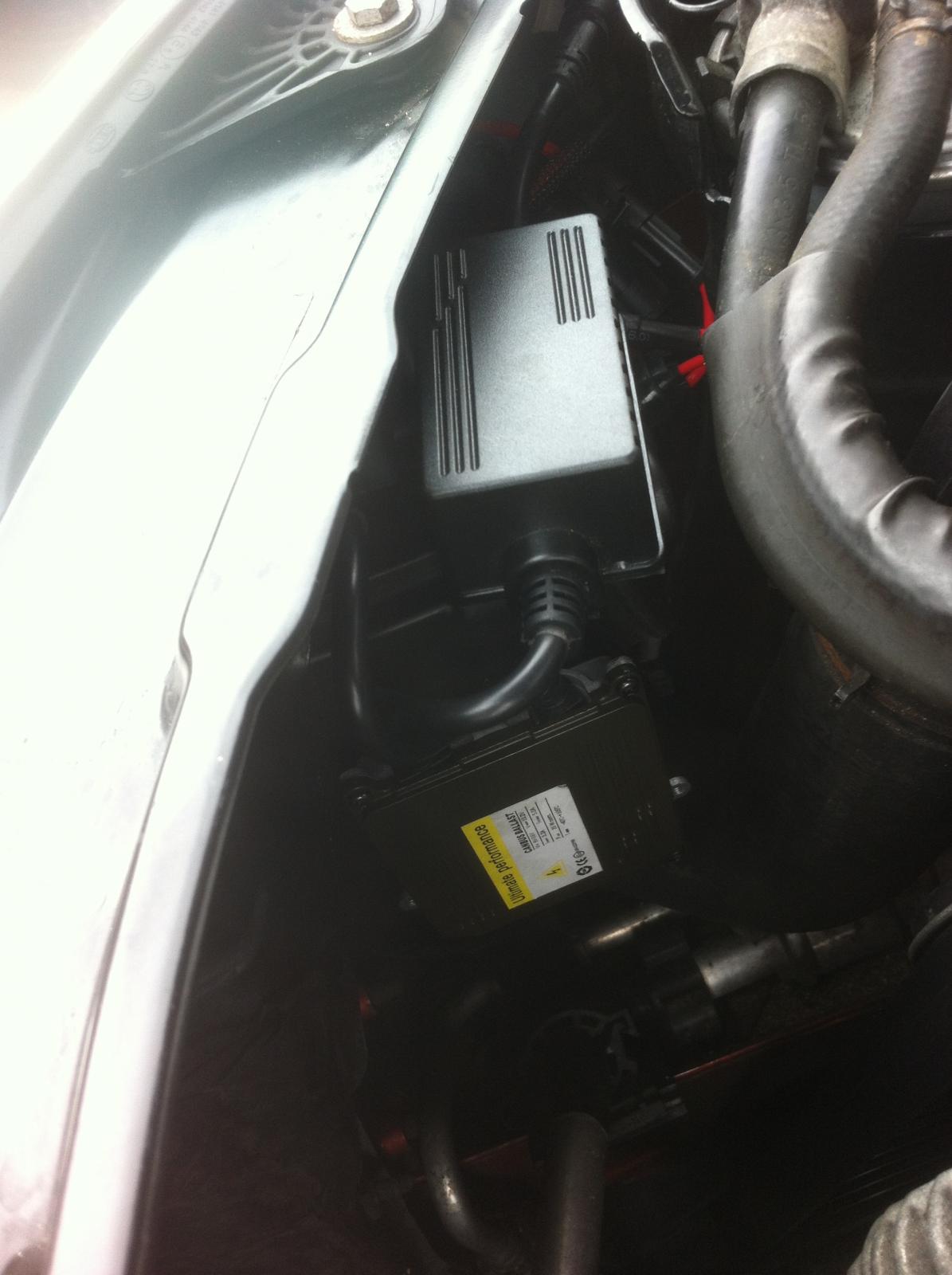

I have 1.9 TDI in my car and everything looks excactly the same as in your car:
I have managed to fit the HID kit to my car yesterday and trust me, this is more tricky and requires much more space comparing to replacing the bulbs. The only thing I did was I unclipped the Fuel Filter and moved it away a bit. That's all...:)
I have managed to fit the HID kit to my car yesterday and trust me, this is more tricky and requires much more space comparing to replacing the bulbs. The only thing I did was I unclipped the Fuel Filter and moved it away a bit. That's all... :)
It must be slightly different as unclipping the fuel filter does not help me. In your second picture you can see a little black tab just below and left of the two loops on the fuel filter. I am assuming these are what are used to release the fuel filter from the housing?
However the housing is what is in the way and when you remove the filter the housing is still there. On my car the filter housing fully covers the sides of the fuel filter.
EDIT: They are different. If you compare your second picture of the fuel filter with the fuel filter on my picture I don't have those two loops that yours has. Also the pipework is different.
Yep...the pipework is different but I think our fuel filters are placed in the excactly same positions...I hever had any problems replacing the H7 bulbs in my car...The side ones are pain in the **$£...
