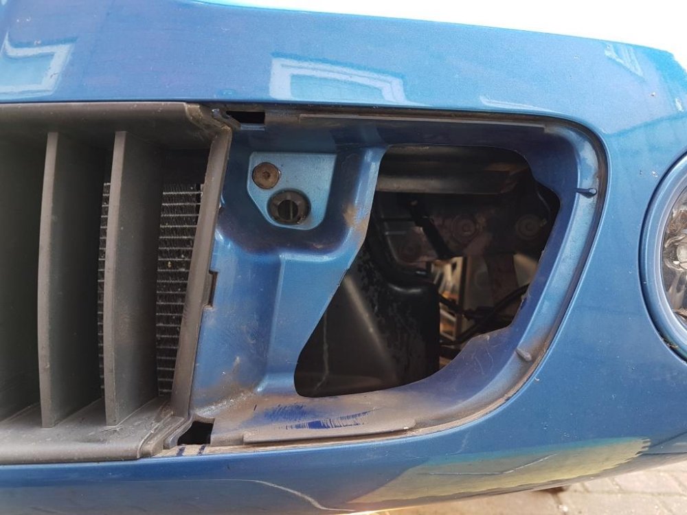

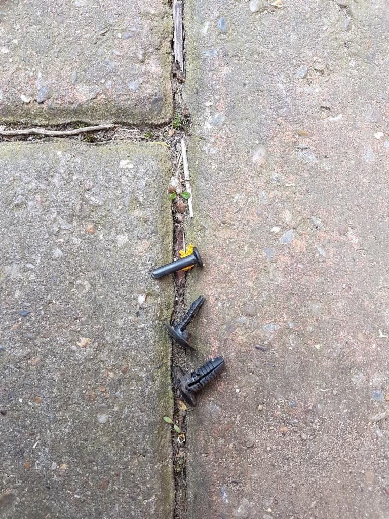

I have been replacing the AC Compressor on an 06 plate Vrs today. Obviously there are a few differences to the above car. I had some trouble removing the small plastic pegs under the headlights, 2 either side and 3 in the middle of the bumper underneath. It seems best to grip and twist the mushroom heads on the pegs first before trying to lever them out. One snapped and I had to drill the plastic pin out. Its probably sensible to have some new spares to be honest as they are flimsy.

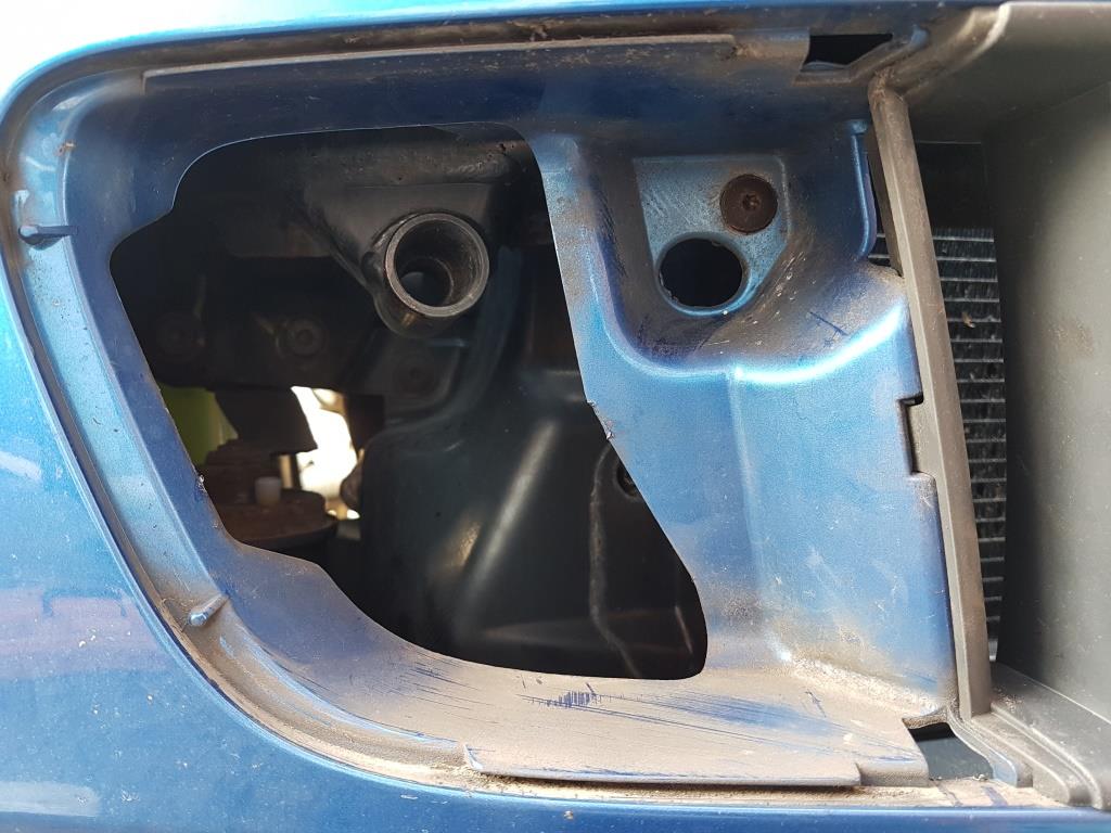

I followed the instruction above to remove the bumper but discovered that there are 2 more T25 Torx screws behind the removable corner pieces of the lower grill. I have also got spare undertray screws and locking nuts as these seem to be the same here and under the wheel arches and some will need replacing for sure.

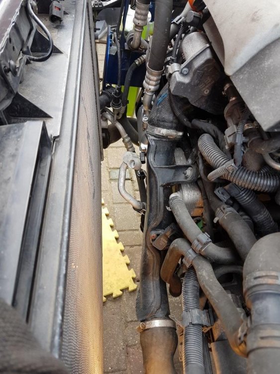

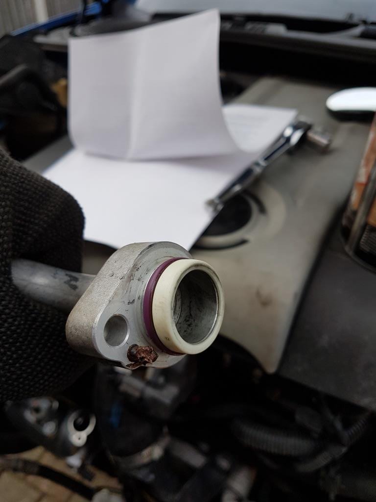

I pulled the front forward a bit but it was restricted by one of the Condenser pipes. I undid the bolt but it was very tight because of dis-similar metals reacting so take care there!!
To enable access to the compressor I removed the fan unit from behind the radiator. This allows plenty of room to undo the AC pipes again the roll pins had reacted Steel to Aluminium so they can be tricky to remove.
