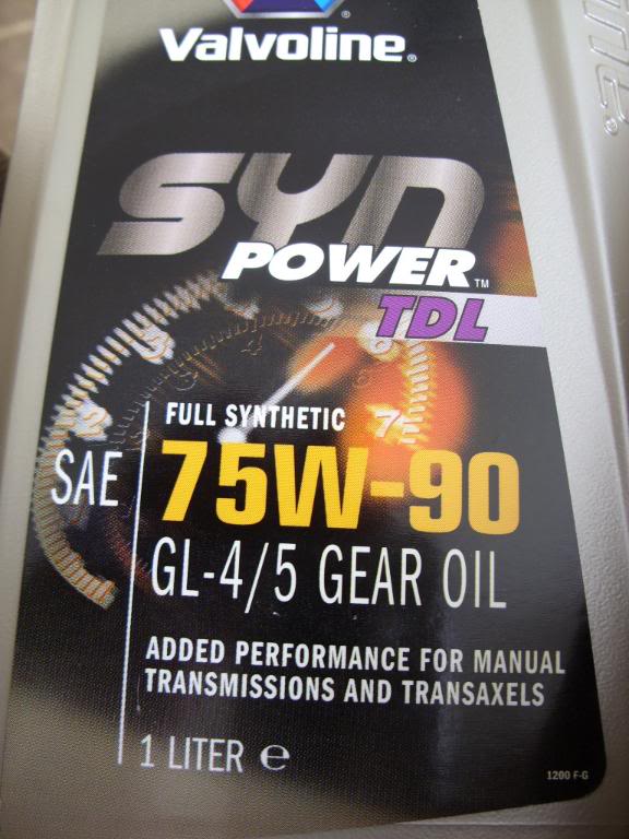

I have this for the old Fabia VRS.
OP refilled with genuine VAG gearbox oil.
