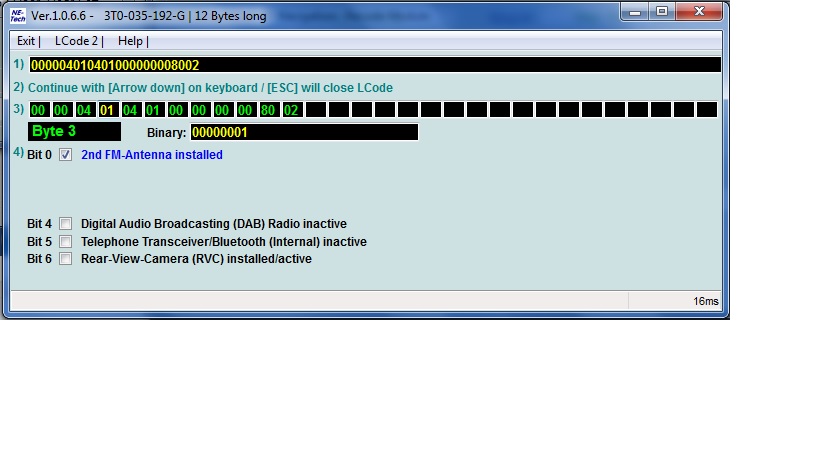

I followed the guide on here but when I go to long code helper I get the following two tick boxes but not Bluetooth telephone.
Its a blackline with Amundsen + so should defo have the option.
Any ideas what im doing wrong, I can be a complete spanner so probably operator input error!

Yes sorry I should have included a shot of the previous windows for clarification. I followed the guide to the letter the tickbox is just not there.

Link says byte 3 bit 5, your screen shot is on byte 0.
I noticed this but how do you get to byte 3?
It says nothing in the guide of navigating there.
Under 3) on your picture.
Click on the 3rd box that currently has 04 in it. That's Byte 3.

Makes perfect sense now, but I didn't know that thanks. Told you im a bit of a spanner, I'll give it a go when I
get home and report back.
Thinking about it might be the next box as the first one is byte 0. Just click through them till you see the option you need.

OK what you need to do is press the down arrow until the fourth byte is highlighted it's the 01 highlighted in yellow. In your screen you will see bit 5 ticked so just untick it and follow the rest of the link I posted job done.
Sorry I missed that you were in the right controller but not the right screen until I just checked mine.

Yeah I wasn't aware there were extra screens for each square I thought I had reached the end of the sequences. Perhaps update your guide for noob / thicko's like me lol. :giggle:  I'll check it tonight but im sure it will be there. I did try the arrow keys but I must have been pressing left and right I even tried tab key lol.
All sorted now guys thanks for help. I did have a minor panic because when i clicked do it, i initially got error7 but i closed the door and turned radio on the tried it again and it acceptedb it the second atempt.
