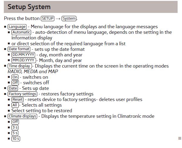

Just found this in the Columbus handbook if it helps..
Going through the menus using my schoolboy German allows me to get as far as selecting English as language.
The message then shown cannot be translated by Babel Fish. It is "Die gewunschte Sprache wird geladen" which I think means "the chosen language is being loaded".
All good, except the message never goes away and the language is never loaded.
