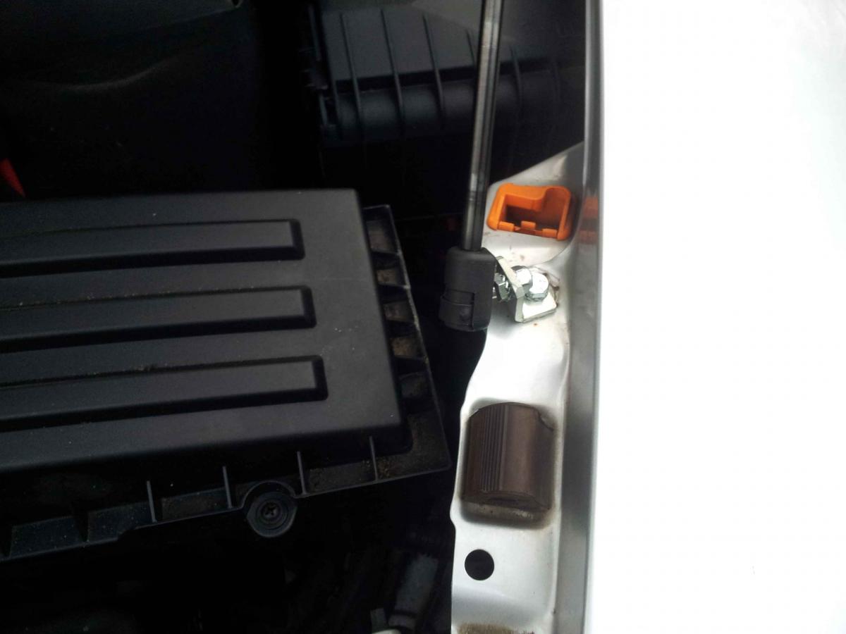

Hi, Got the kit today how did you guys fit the lower ball bracket did you have to drill a whole?
no there is a bolt to be taken off for it no need to drill atall

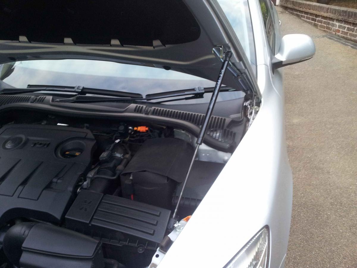

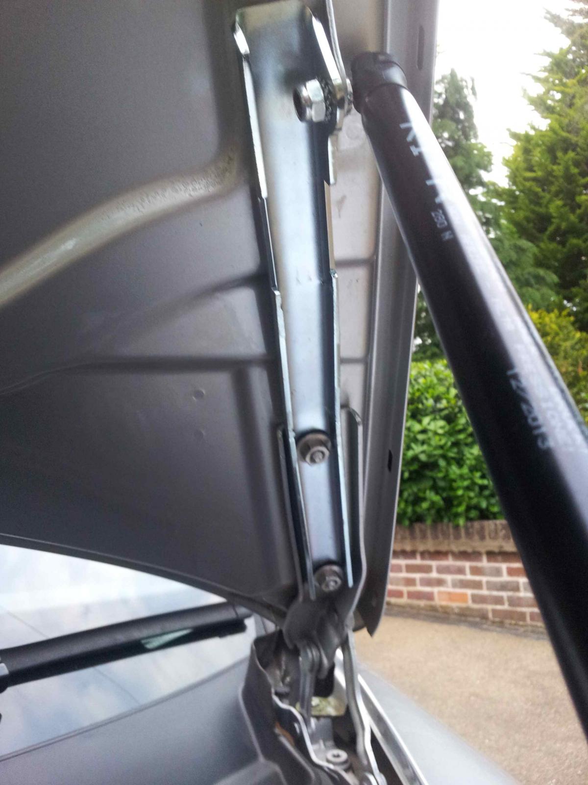

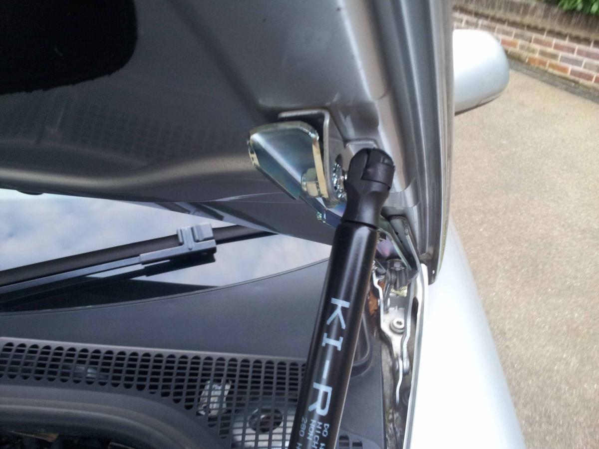

Job done thanks for all your help
Have you got any picture.
Yeah, any pictures?
Cmb they look good but I just don't like that bottom brackets and that would bother me just don't look neat but I definitely like your grill.

Cmb what did you do to fit the right hand strut?
Sorry for the delay but like most of the country the weather has been terrible
