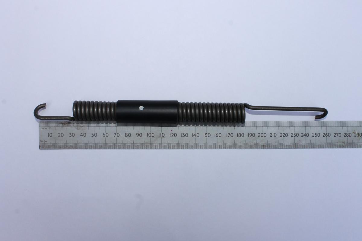

Hello everyone,
Discovered this in my driver's footwell on the way home from work this evening and I'm wondering where it came from. After having a good rummage around and a look through the Haynes manual I am none the wiser.
To be exact I found it with my right foot on the mat under the accelerator pedal.
I'm thinking it may be from one of the pedals or perhaps from the seat (could have rolled forward under braking)? Also, the car was in the garage last week having a wheel bearing changed so could it be something a mechanic left lying there by mistake? It looks like new; no scratches or anything.
Car is an '02 RS.
Any help would be much appreciated, thank you.
Its from underneath the seat, most of us have lost these now given the age of the MK1's now. don't worry won't affect the seat  operation in anyway
Thanks andy68.
Any idea where it fits? Although glad to hear it's nothing major I wouldn't mind putting the pesky blighter back where it belongs!

Ages ago (I posted about it), I found 3 bits under my seat.....  Pretty sure the seat doesn't go up/down anymore.  I am sure the spring hooks around part (2) which had broken off.  I think you get 2 springs per seat....
close up of part (2)

Just found the thread you posted in... seems a common occurrence and like most my seat still appears to work just fine so if my part 2 is broken then I'll leave as is.
Feels harder to jack the seat up while your fat butt is on it now, so I'm guessing it's a helper spring for the seat height adjuster. Still adjusts though...

Because - only last week, I found exactly the same spring and bit of broken plastic rolling around in the driver's footwell of my '51 plate!
I thought it was probably a seat base spring - but wasn't too worried as my seat base still feels ok - even with my fat, 18 stone ass on it!
