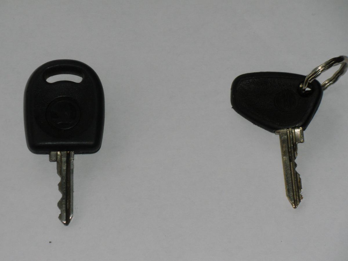

BUT -  he puzzled at the key blade on the key I now have to turn replacement lock ( taken off Felly diesel car)
He eventually found it in a book - shown as a Shown  key -  but with a different shaped plastic - ie not the normal; symmetrical plastic shape but a more one sided smaller one
These cannot accommodate the chip
So,  it looks like I am looking for another felicia  ignition switch /barrel with a normal shaped key - that I can get a new key cut from and get transponder code added!

Can you put up a picture of the key for me? Don't go paying out anything else yet till we've solved this, as far as I know there has only ever been 2 types of key blade used on the felicia models.
Thanks
Will take picture in morning and try to put on ( not that good on computer type things but will get it posted somehow)
The guy in Timpsons was also a bit puzzled, but did then find a diagram of it in his book under Skoda title, but said it was not a transponder type key.

Tried to post pictures of keys – but not a lot of success ( I am not that computer literate )
Will try again later as it may help for future queries

Up early this morning, had charged battery all night, as it could not start again late yesterday.  With hope in my heart , I tried with original key against sender – no go.  Took pictures of key to post ( another failure! )

Thanks to those who  patiently tried to help, especially Teflon Tom. I will try to get pictures of keys on
you can swap the transponder chip between keys too, it is only glued in , if you open the key and soak the chip in thinners it will fall out, swap it to the key that works the ign barrell and job jobbed.
