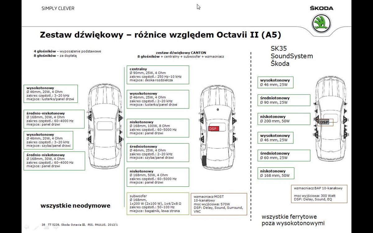

No, I think I was missunderstood. No Canton system upgrade. From what I know, the standard number of speakers on Amundsen MIB is 8, and in the configurator I can choose extra 4. so they're 12 total.
That's not an option we get in the UK - it's a standard 8 speaker system or the canton with a subwoofer in the boot and an extra speaker in the dashboard.
I believe it is the third configuration on this image?
Hopefully should give you more info :)
Very interesting, thanks
No dont think that is correct if you order Swing and above (so Bolero, Amundsen or Columbus) you'll get 8 speakers no matter what, is the standard fayre on those systems.
V boggo spec EU models come with a Dance head unit with only front (4) speakers I believe.
The 12 speaker system in that diagram is the Sound System upgrade from the Mk2 and not relevant on the Mk3.
