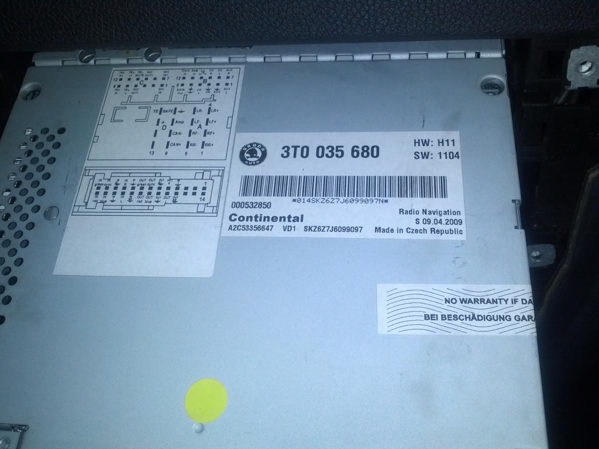

Short answer is 'yes' to both questions.
To get the right / latest firmware you'll need to know the part number.
You could go to 3810 without issue. IIRC that has 7 digit postcodes.
You'll need a map disc and will have to put your music back on (as you've only had it a few days I doubt you have much on there).
If you are near Hereford I can sort the DRL's for you.
PM me about the firmware. I have discs.

Here is the label on the top of my unit...
