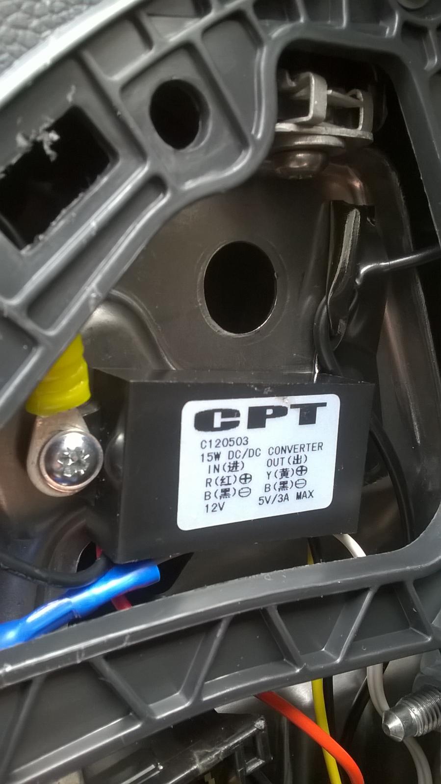

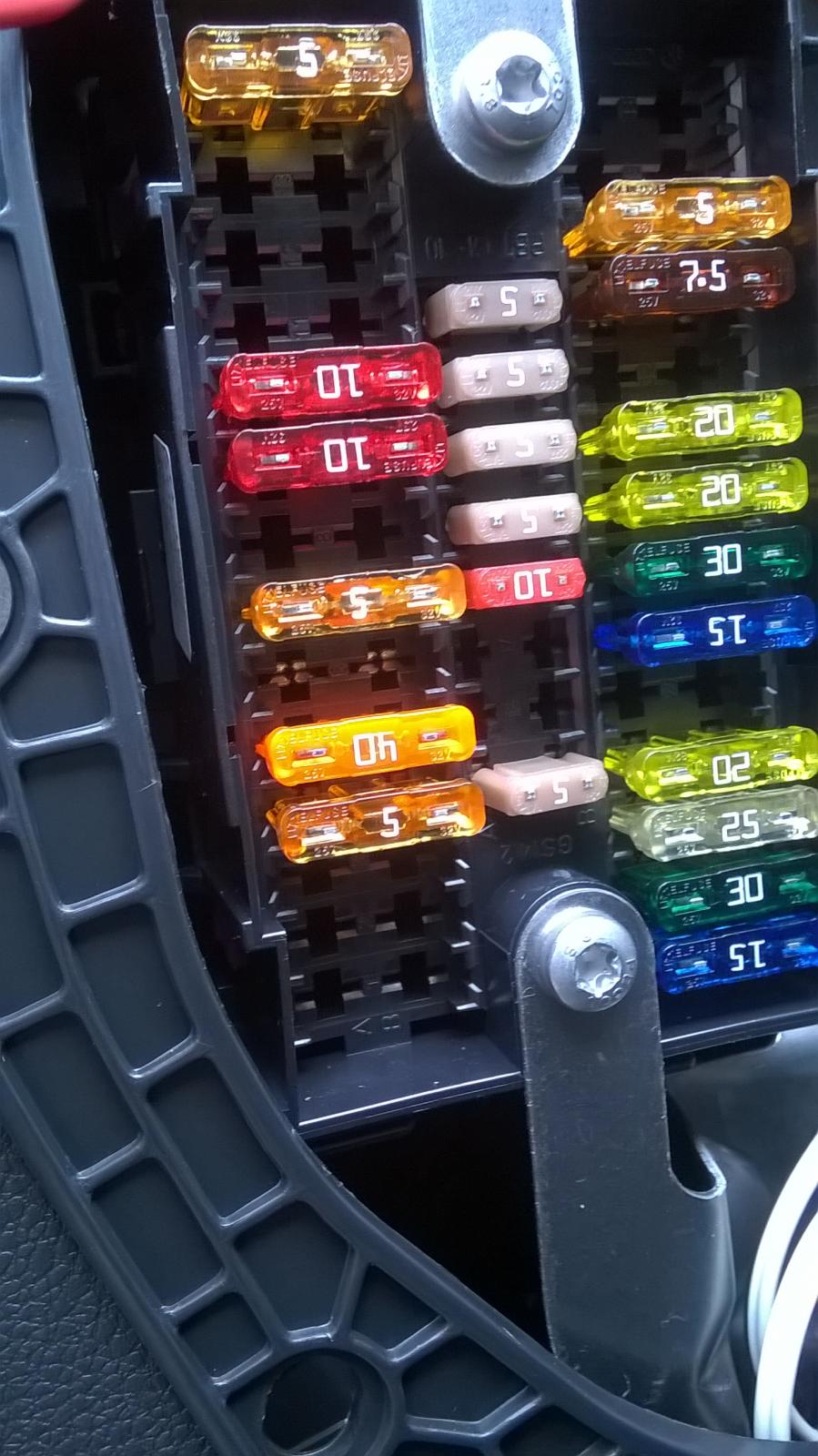

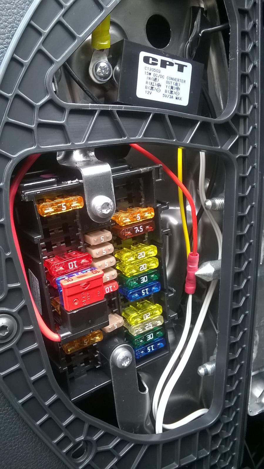

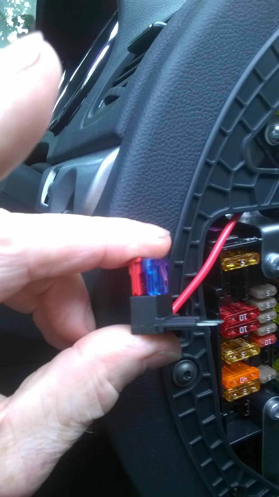

I completed my dash cam install yesterday.  I managed to get the 5v supply wiring tucked away pretty neatly, though I say so myself.
Unfortunately it turns out that the GPS part of the dashcam is faulty, so the unit itself is going to have to go back  :swear:
(Anyone got any tips about getting those 3M sticky pads off the windscreen, apart from Techmoan's dental floss trick?)
Just some photos for future reference.

How did you get that s/t screw in?  I couldn't get a drill into the space to get enough purchase to drill a pilot hole - the metal there seems fairly tough.  I gave up and used velcro sticky tabs in the end and earthed the 5v adaptor to the torx screw holding the actual fuse panel in place.

If you intend to fit a power socket and use the dash-cam's own plug to connect up, then you don't need a 12v to 5v transformer.
If you intend to snip the plug off your dash cam's lead and connect straight to the power, then you DO need a 12v to 5v transformer or you will fry it.
chip 7905 or 7805'll do it!!
Thanks for that, i ordered the bits for both ways so i should be good  :D
