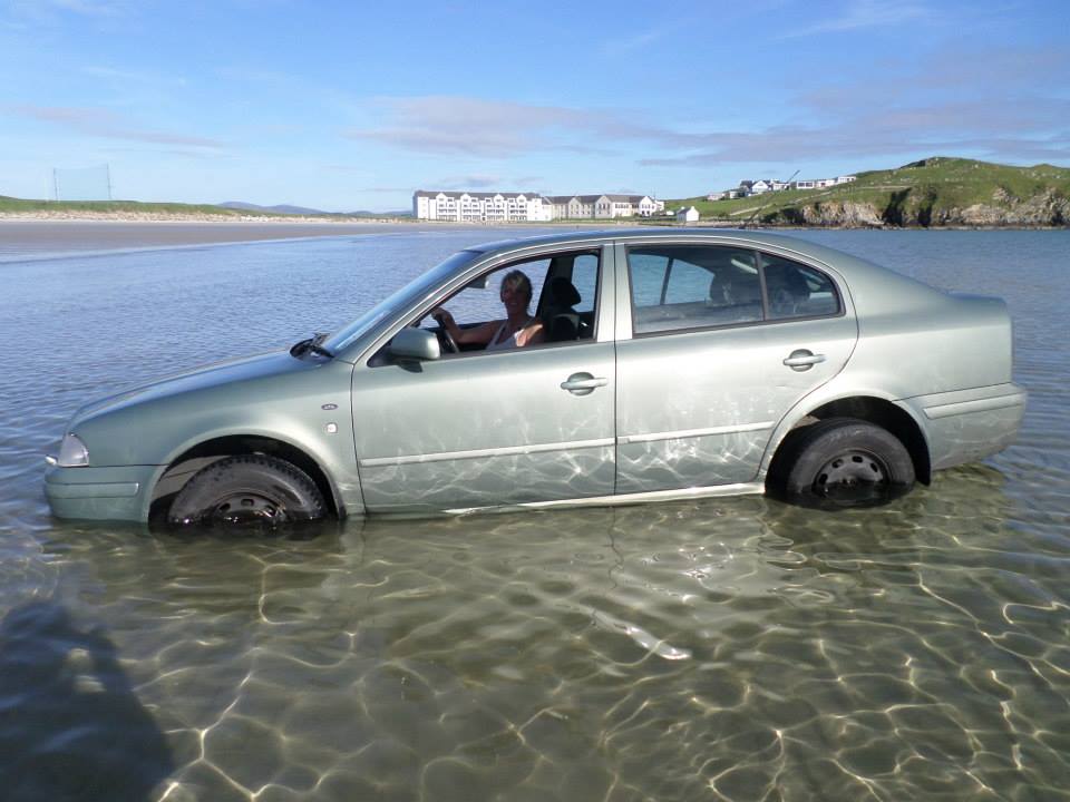

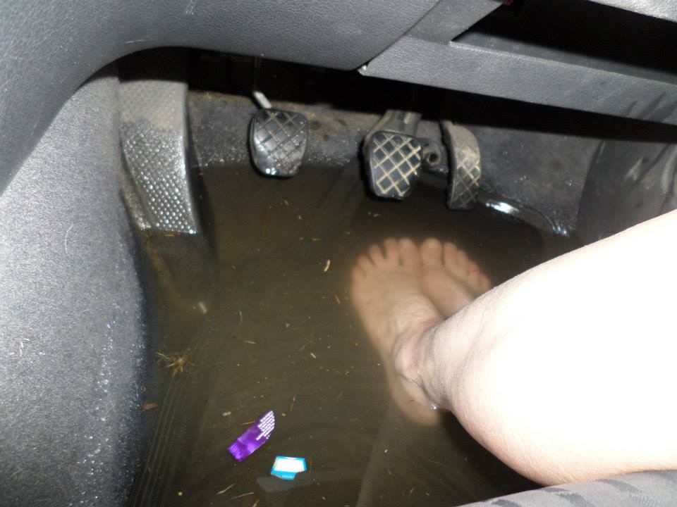

Well still no sunroof or windows.Here she is having the bath and the high tide mark.I tried to upload a couple of pics of the wiring that was put in on the relays with two fuses,a 20amp and 30 amp.One looped into the yellow and black wire and the other looped into the red wire second one over from the yellow and black.Can anyone enlighten me as to what he was doing please.

Was the airbag controller submerged? It sits on top of the tunnel between the front footwells and based on that 2nd photo I would have thought it would have been underwater.
Sent from my Nexus 4 using Tapatalk
I don't think so as the high water mark didn't go over the tunnel,there was some soakage.And no fault code showed for the airbag when the diagnostics were run.Though if it is a case of changing this,would it be as simple as disconnecting the battery,unplugging and replacing?

The Mrs seems surprisingly happy in the pic
