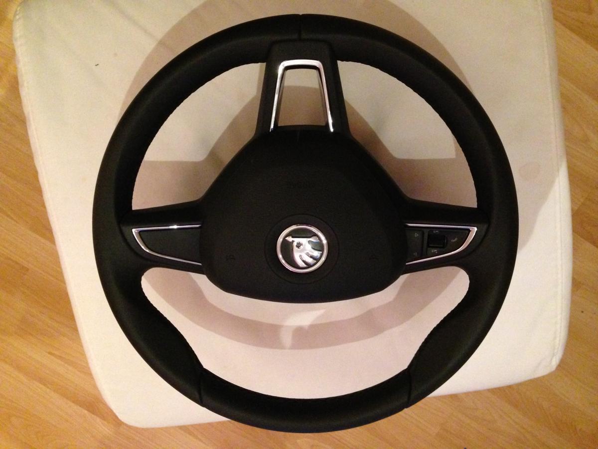

I've just retrofitted my 2006 Octavia 2 (1.9 PD, Elegance) with a MFSW taken from a 2014 Fabia
Here it is... post-110854-0-99074000-1403204050_thumb.jpg (the picture gets rotated as soon as I upload it, dunno why)
While it looks awesome, unfortunately the buttons are not functioning (no light as well), the horn does not work, and I am not quite sure if the airbag works, although there is no warning light for it.
Could you help me with an advise if you have experience with such steering wheel?
Can I make it work?

Did you change the steering wheel controller and wiring harness over?
Phil
Nope, I am not aware of the exact controller that I should get.
What about the wires? The cable plug fitted perfectly. Should I make any changes to it?
MFSW will need a highline controller and a different loom, connectors will be the same, just more cables to the slipring.
also.. i didn't think you could retrofit that new a wheel? :/
Get a VCDS reading to find out what type of controller you have , A search on here will tell you if it is correct for a MFSW.
My FL Octy vRS just needed an updated controller along with an addtional cable for airbag & buttons. ( this came complete when i bought the wheel)
Once the new wheel has been fitted you will need VCDS to change settings to activate the buttons.
Do a search around on MFSW, as GIZMO68 coded mine & you should find some useful info.
It can be done but I think you need to swap the buttons too as the wheel isn't recognised on pre-fl
Phil
