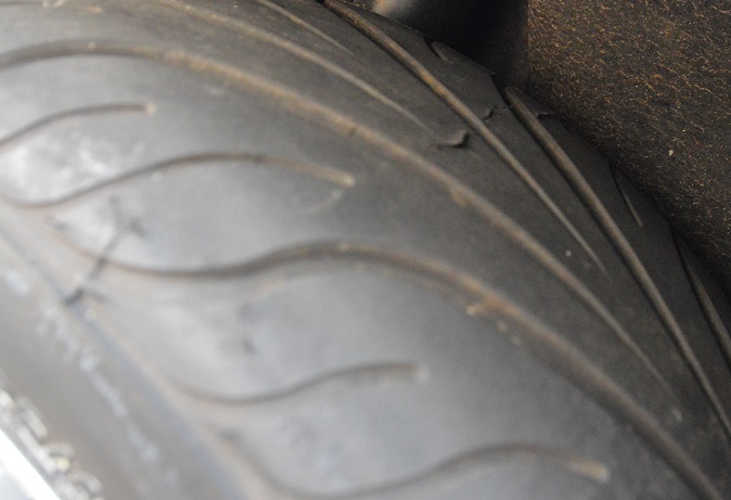

If you have these, just check the tread is OK.
One of mine is starting to seperate after 400 road miles and 30 minutes of track work...

Mine are doing this also but I have been told by Demon Tweeks and Federal that this is normal..  Not too sure myself but as they will have a short life I am not too fussed

It's normal for the 595 RS-R's they all do it.
It's apparently a moulding line and nothing to worry about.
If it's normal I'll not be buying any more.
I know they are cheap, but it doesn't fill me with confidence when I'm bombing along at 100mph+ and late braking into corners.
Never seen it on any tyres before.
You will be fine, it doesn't go that deep,  by the time you have run a few laps you will have worn through it  :wonder:  so they say.
Mine after a 1062 mile road trip inc 2 laps of the ring:
The rears were still unmarked, but since doing 70laps of combe there starting to look similar now.

Maybe I'm fussy, but I wouldn't drive on tyres like that.

I know what your saying but it's something that is well known with these tyres and people have moaned about it for years, but there has never been any issue's and you do eventually wear it level again (well maybe normal people do, i've actually made mine worse lol).

Mine have never worn like that with splits on them.  I shall be keeping an eye on them just in case but after 45 minutes + 1 full trackday at Combe they are looking OK - apart from being a bit worn on the front left :D

I have 2 RS and 2 RSR... don't know which are on where on my car! lol... but it handles nicely.... mine also have a slight line like the others posted, so it must be a normal part of the moulding process...
I'm not worried about it, they feel good, and grip more than anything I have ever tried... if they were to start to delaminate (thats not whats happening) you'd soon know about it, you would loose all balance, and grip.

Mine have done the same.
Seams to happen on them all.
OK, after Cadwell my RS-R's have worn through the split of doom and gloom, in fact they have started to fill in the grooves with the amount of rubber that has worn from them, wheel arches have sticky rubber stuck to them, so they got hot and I have to say performed very well in the dry at Cadwell.
