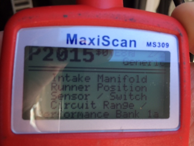

P2015 fault Code - New Intake?
My fault light has come on my 2009 FL VRS TSI and has advised code P2015 which I believe doing a quick search that this is a common issue across VAG.
Am I right in assuming with the TSI engine this is a complete inlet replacement?
How much should I expect to pay to replace parts and labour?
Thanks
