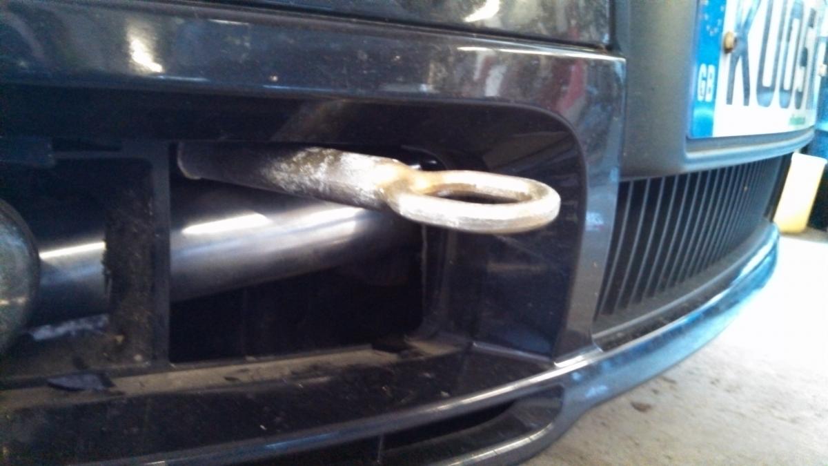

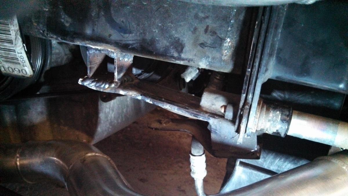

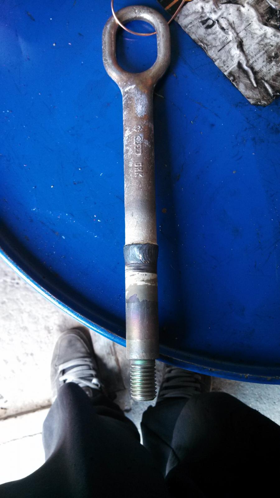

Here is what I done to retain a stdish towing eye without fear of smashin or having to remove the front end of the car to tow it... simply... get an Audi or similar extra long towing eye, graft it to the Skoda one as in the pic. Drill spot welds then angle tow socket until desired then weld in a packer - box section or gusset to suit. Was going to cap the whole affair after taking photos for u guys :-) hope this helps
Nice one!
I went for a TRS tow strap welded on!
