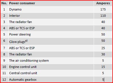

Link # 3 across the battery is also listed as the radiator fan ~ 40 amps.

Cheers, I'll have a look at that one.
Number 3 looks fine too, so could be the fan motor as mentioned.
