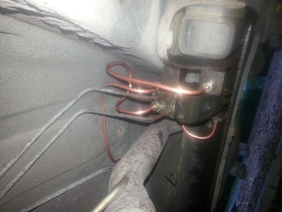

I had same problem with my local tps saying discontinued so I just removed mine and took to local motor factors and they made some to length and just used old ones to bend them to fit
just a pic to show the new pipes bent to fit
Many thanks (and virtual pints for TeflonTom). uma1998, star pic!
