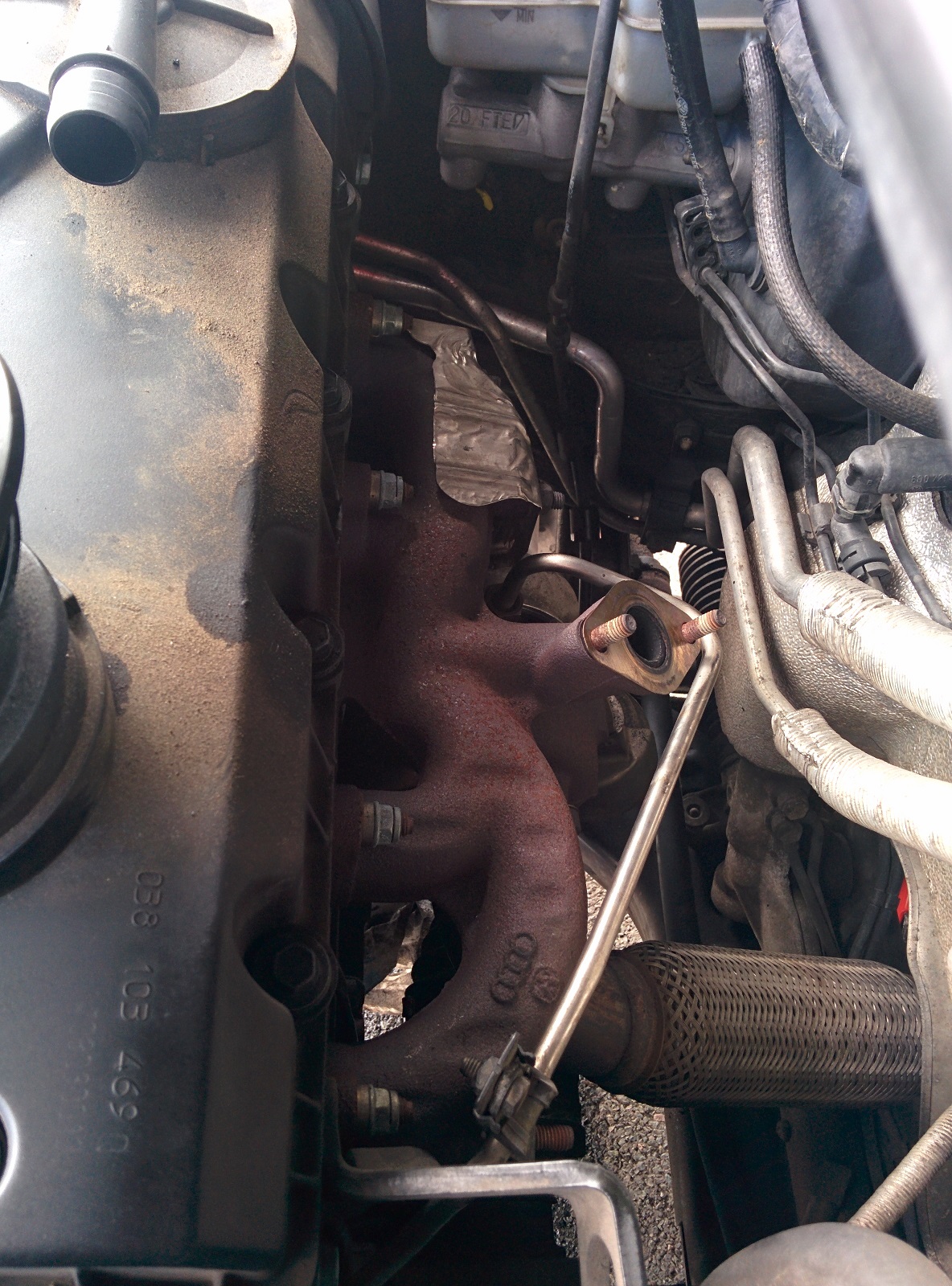

Air intake manifold off. Getting there slowly.

I am missing something? I removed all 8 nuts from the turbo housing, the exhaust pipe, the oil feed line and the oil return-flow line but its not coming off. Its loose & the turbo side is pretty free, but the right hand side seems stuck on something. Is there anything else I should have removed but have missed?
edit: missed the bloody lower bracket by the oil return line!

Right its off!!
The implellers look undamaged but theres a lot of movement on the intake axis side & the outlet side moves a bit too.
Looks like a lot of play, how much is there if you pull it in and out?
Also is the shaft still complete?turn one end and hold the other to check shafts not broke.
Shaft seems broken as both impellers turn independantly. Cant see any signs of debris or particals in the turbo or pipes.
