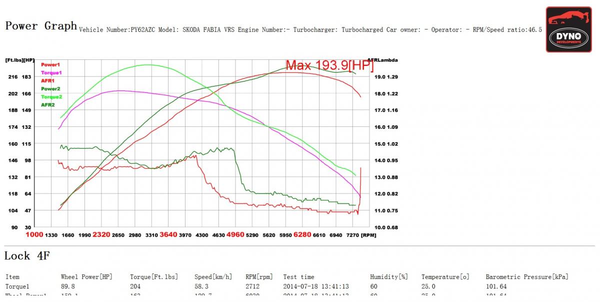

Here now just getting put on rollers. Il take a video. Doing standard run then with the box on
Just got 187 standard. Now second run. Fingers crossed.

Yeah and sedox tuning. 194 with box on and 20lbs torque more. For the money paid lad said its worth it. That was on 2nd off last setting. Advised obviusly remap better but for 125quid . Il get the graphs up

The graph

So 187 stock and 194 with box on? To me the gain looks rather unimportant even for a mere 125 quid as you say. Why not enjoy the free power boost from Skoda on an engine that on paper puts out 180ps as it is ...
Edit: I just saw the graph, the torque increase between 2 to 4.5K is not bad but apart from that I see no other significant gains.

No that was on setting D

Its the way it feels to drive. There is a difference. Be it more torque

Well the lower down torque is good enough for me. Very noticeable difference driving with it the box on than off.
Not knowing what fuel was used, is a service needs doing etc it's difficult to judge really. Tbh I would be a little disappointed as your engine stock is nearly 10hp more than mine and you still a fair was off quoted figures for a cave engine. So going on your gains, I should be getting less that you did at stock. I would have expected to see around 210bhp from a cthe engine. If I only get 10hp more, I'm sending the box back.
Yeah it makes sense as it's the most useable rev range for everyday use.
Still, I don't get how a CAVE engine with one of those is stronger at circa 200 hp. I understand if an ECU is locked and can't be remapped but then these boxes should either be giving 0 gains or more gains than the CAVE versions, say 210 hp. Can't explain this minor increase although no techie by any means.
97ron fuel used. Service due 2000miles. What are the actual figures these tmc boxes are achieving and not what they quote?
It's somewhere here if you look it up, quite a few of them. Certainly more than 7hp gains though that I remember for sure.
Be interesting if someone has a figure in a cthe engine like mine with a tmc box. and there standard run then with the box on?
I wouldn't be surprised if a CAVE engined car produced the same figure as the CTHE one with the box attached. Therefore giving the greater gain. All the box is doing is altering ECU signals to it's predetermined settings on the Bluespark box. There isn't toe different boxes for CAVE or CTHE you can buy??
It's like the 1.2tsi if you map either the 105 or the 86bhp one you get the same end result of 125!
But here we're talking about less end result between CAVE and CTHE and one in favor of the CAVE strangely. I don't recall any Bluespark box reviews though, only TMC ones on CAVE engines. Maybe there's a difference between those two (boxes).

My standard bhp 187 im happy with that. Although 194 with the box on isnt hardly a
Bhp difference it does feel better because of the torque. Its staying on anyhow
