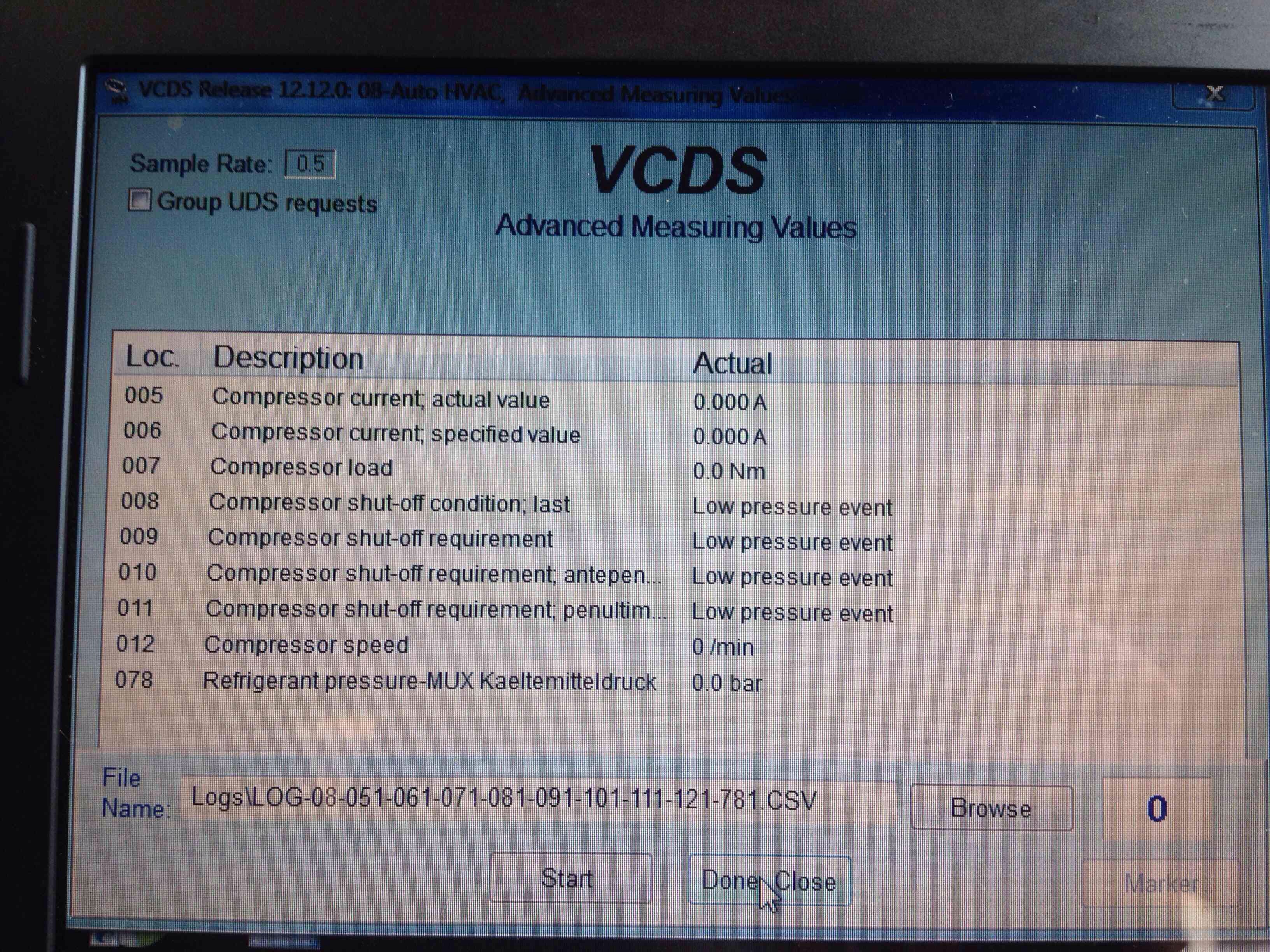

Done a scan with VCDS and came back HVAC coolant low pressure. Also checked the measuring blocks and get this....
So, knackered compressor and zero coolant?

Compressor won't kick in if the lower pursue threshold is reached so compressor might be ok, just looks like you've no refrigerant in the system which would almost certainly indicate a reasonable sized leak
cheers guys, will look into this tonight.
The car is going into a garage later on today to be checked for gas. Did the trick with climate, the compressor is turning.
