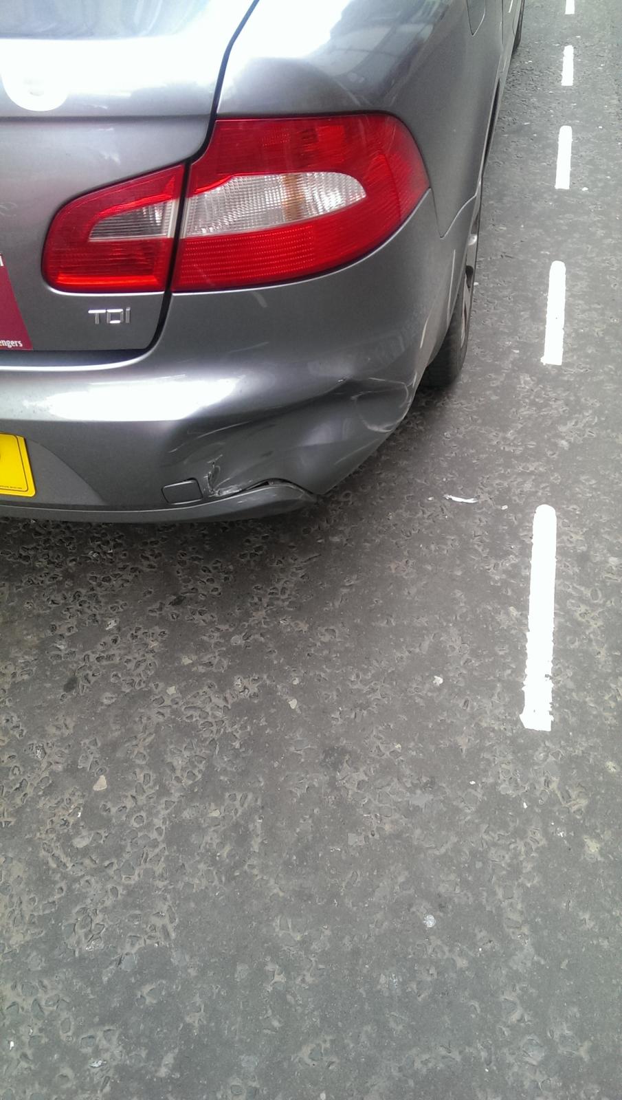

Decided to get some paint to touch up the damaged bumper, so went to Halfords, they use the paint code from the car to mix,, but its a much darker colour, so what colour is mine can anyone help from this photo

Just nip down the dealership and get the correct colour?  The paint code will be on the big data sticker in the service book.
I've heard the Halfords paint matching is a bit of a hit and miss affair, best as said get a dealer or a specialist to match it.
Bit beyond a touch up though that damage.
Yes, I'd agree with that. They made a right mess mixing the touch-In paint for my son's Grande Punto, but got it right on the third attempt!
think you will need more than touch up paint to repair that bumper. :D
Yes indeed! Should polish out though!

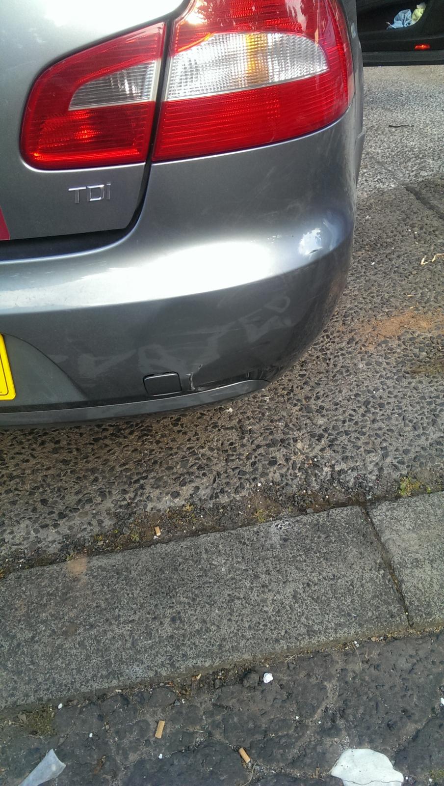

It was 90% sorted half an hour after it happened just used the car jack to push it back out and a £2.00 sucker from B@Q, the bottom bit just clicked back in once the tear was fixed, with a bit of plastic filler
