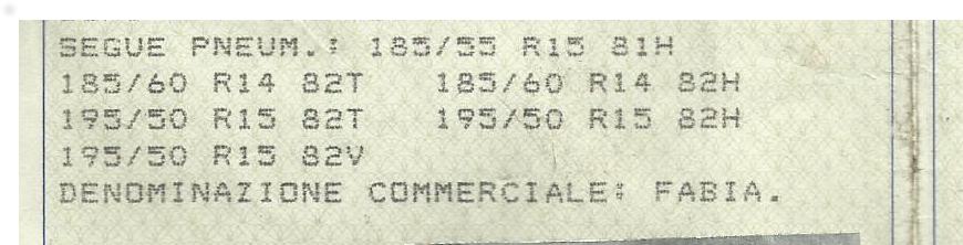

Hi there I have a 2001 model fabia 1.9tdi (red DI) comfort which has 15" alloys on the when I'm driving on the white lines of the road or when the camber changes on the road the car pulls all over the place so I've bought a set of 14" steelies but I don't know which size of tyres to get as the fabia diesels list few different sizes .can someone please help me and tell me which size do i need .
Thanks. Paul donachy
There is no way for us to tell because the new wheel could be various widths, you you will probably have to take it to a shop so they can look and see what the size is. but you problem is more likely going to be down to a tracking or suspension problem than its likely to be about your wheels.
I know the width 185 it is it's the profile size I'm stuck on really
standards where 6jx14 for a comfort spec fabia
tyre size being 185/60/14
if you plan on keeping the 15s
it should be 195/50/15
+1 crpvrs
I will go with 195/60/15 though ..
thats providng the steelys are 6j
Yeh steelies are 6j...
Yeh the alloys are 195/50/15s..thanks lads so 185/60/14s it is then
The sizes should be on the inside of your fuel flap, usually all the certified ones for various diameter wheels.
But as above, 185/60R14 is correct.
I've had mine since  factory fit tyres and they are 185.60/14. But as said, problems you have are either down to wrong pressure or suspension problems.
