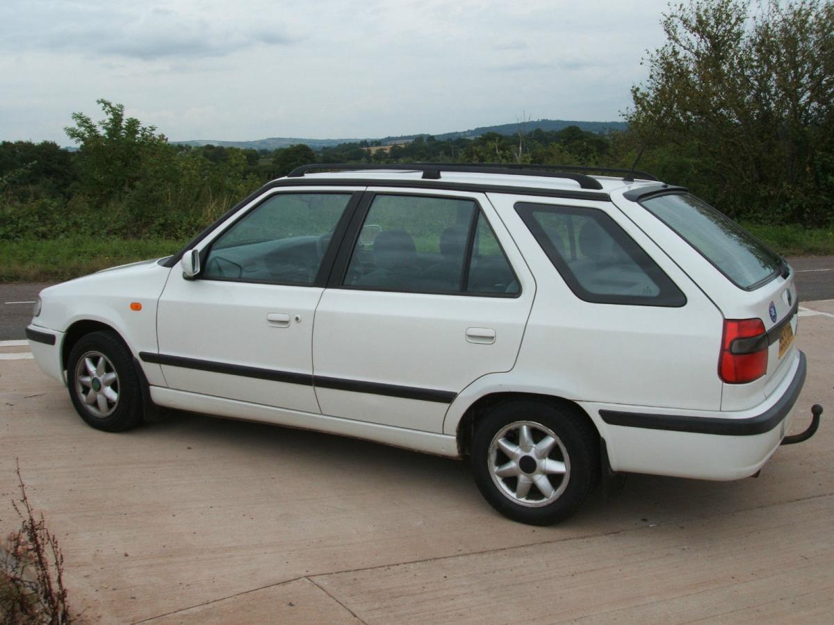

I just bought my first car which is a Skoda Felicia GLXi Estate W reg for £500 and was just wondering if anyone could give me a few tips on how to keep it in good order?

Looks clean, good purchase and happy motoring :)
hi, nice clean usable motor, without wishing to disrespect yours or any fellow felicia owners, from experience on my fathers previous car, these can suffer from wheel arch and rear tailgate corrosion, if yours is sound keep the inner wheel arches free from crud on a regular basis may seen a bit of a faff but will pay big time in the long run
