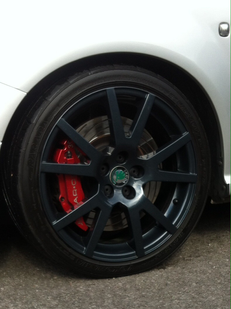

iv fitted leon cupra r 323mm with 4 pot brembos and 5mm spacers behind spider alloys
I'm running Tarox six pot calipers with Tarox f2000 discs 323mm with my 17" spiders and not running any spacers :)
me to with audi TT wheels no spacers
