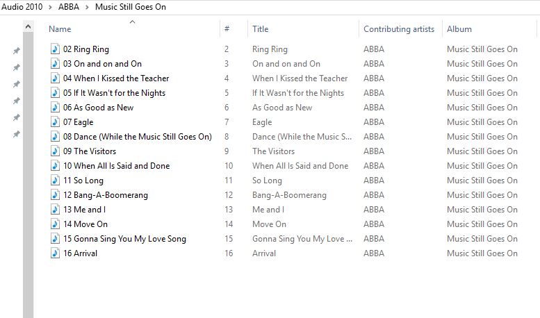

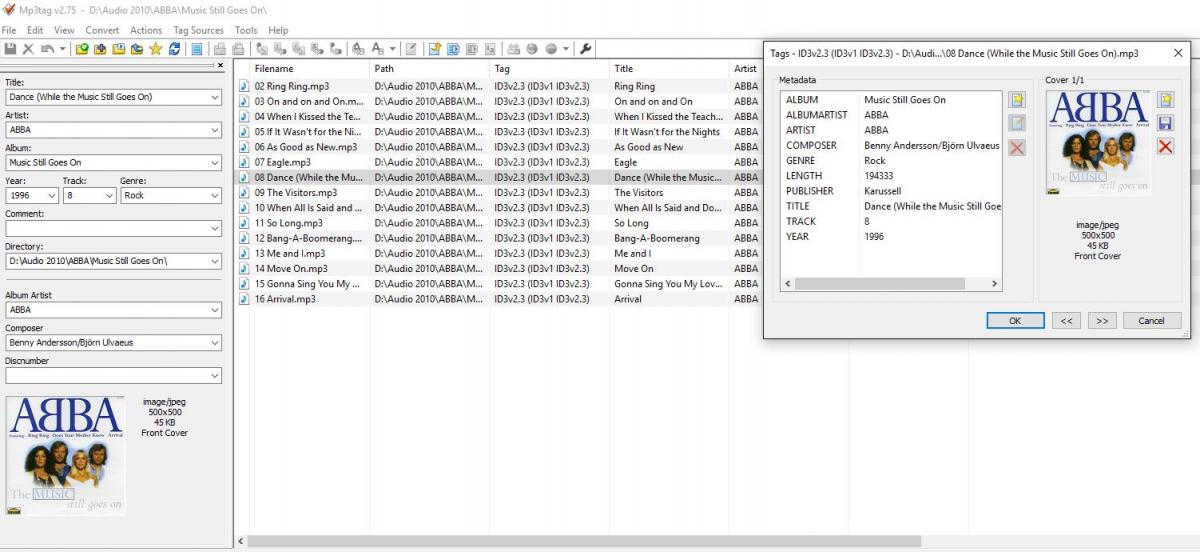

Not a lot of luck so far, opened some of my folders containing the tracks and as CD above suggested hit 'extend tags' after about a dozen files showed no artwork I opened WMP and found they all had artwork shown there. I then opened the ABBA files Abba 'Gold' and 'The Music Still Goes on' in Mp3tag and selected 'Tag Sources' and Amazon.com and found both covers that seemed to work. I found that some of my music files were on Amazon UK but that option does not appear in the Mp3tag options.
I am truly starting from total ignorance on this subject, and struggle to comprehend why WMP and my out of date Avensis had no trouble displaying artwork without seemingly any problem. It would seem my music files only contain the music and nothing else.
As said I can find 'The Best of Dreamboats and Pettycoats' triple cd set on Amazon UK and is shown in WMP but Mp3tag cannot find anything reporting 'Sorry, no entries are matching your search criteria'. There are 3 cd's and WMP shows the 3 cd's with artwork for each.I am obviously not doing something right. Tried the 'Getting started' pages but think they are for someone who already understands what they are doing and terminology to go with it.
WMP will save the artwork as files in the same folder by default.

Snippet screen shot of my ABBA The Music Still Goes on attached. There seems to be only mp3 music files shown. I have 'show hidden files' ticked in Files and folder options.
Snippet also shown from mp3tag showing the artwork. If the artwork is saved in the album folder why does it not show up?
Warned you I was starting from scratch!
post-122273-0-83137500-1458752571_thumb.jpgpost-122273-0-51325400-1458752601_thumb.jpg
That's how my music files look in mp3tag and the artwork shows up just fine on the Amundsen.
Enable view system files as well
