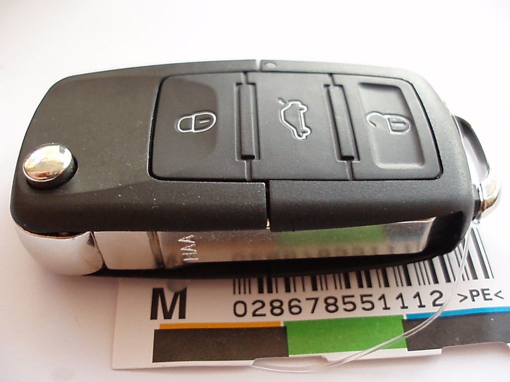

does your remote split like this in the pic below? or is it the newer type like in the 2nd pic? well, apart from VW logo, just the type of case

The keys are the newer type, as in the second picture above. There is no undue resistance in the ignition.

i have seen them break before, but then again i do 200+ VAG keys per year. Although i've never seen 1 break on a car of that age & definitely haven't seen 2 keys for the same car break in the same way. Could be stiff/sticking ignition barrel so having to put more effort to turn it or possibly a seriously huge bunch of keys/keyrings attached to it
If the OP could reply to my above post where i ask which type of key it is i may be able to help further
Actionman39, i agree with what your saying, but please see quote below. I think its 2 posts up or something.
