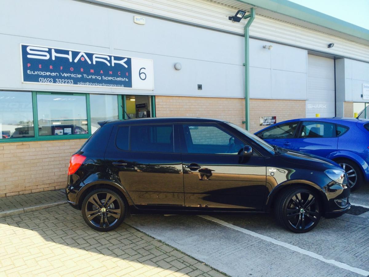

Here it is when I picked it up. Looking clean, but a little on the high side!

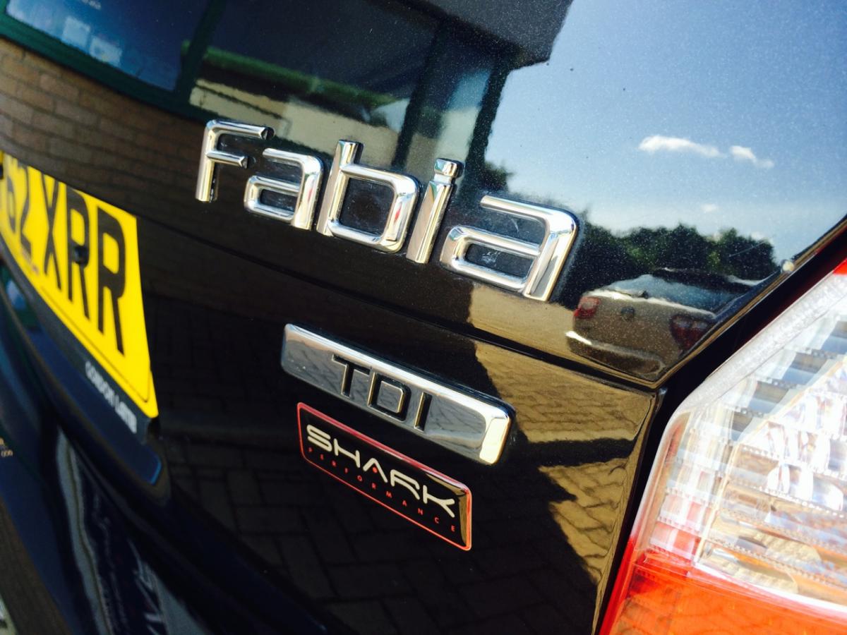

It didn't take long to get a badge.. however I didn't have chance to map it on the day I bought it because I had to dash straight out

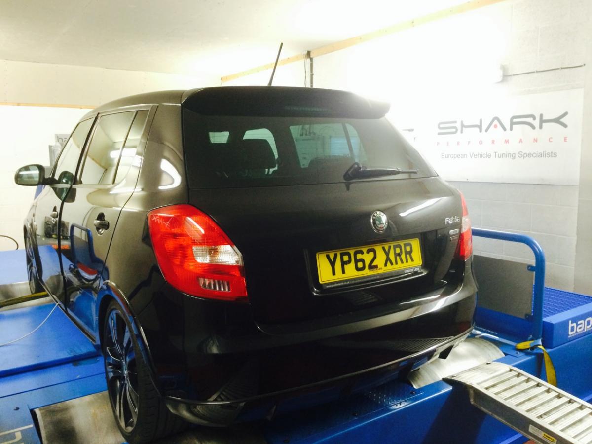

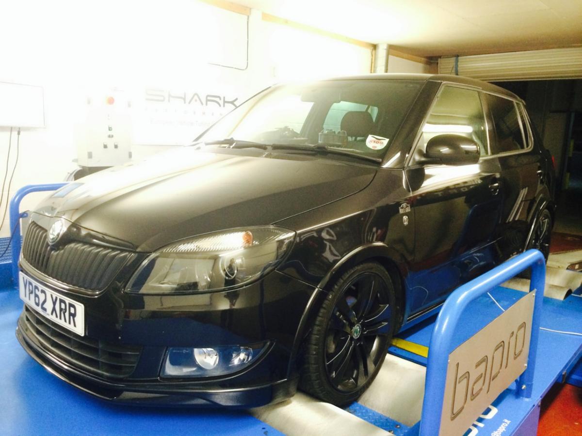

Mapping came last week, on to the dyno for a bit of out of hours tuning
The eagle eyed of you will notice that the car sits a bit lower in the dyno pics.. more to come on that but a huge thanks to our friends at Eibach for looking after us on some Pro Street coilovers.

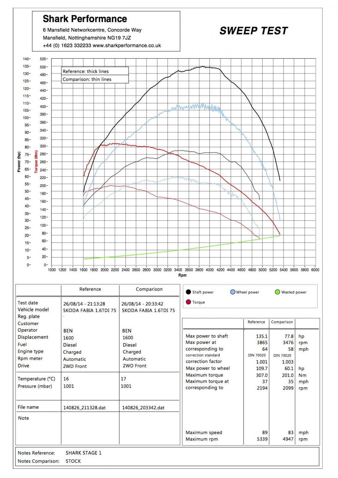

The all important curves! 77bhp up to 135bhp
