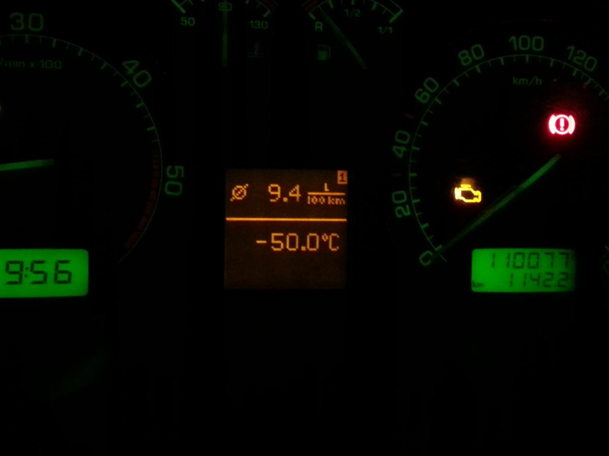

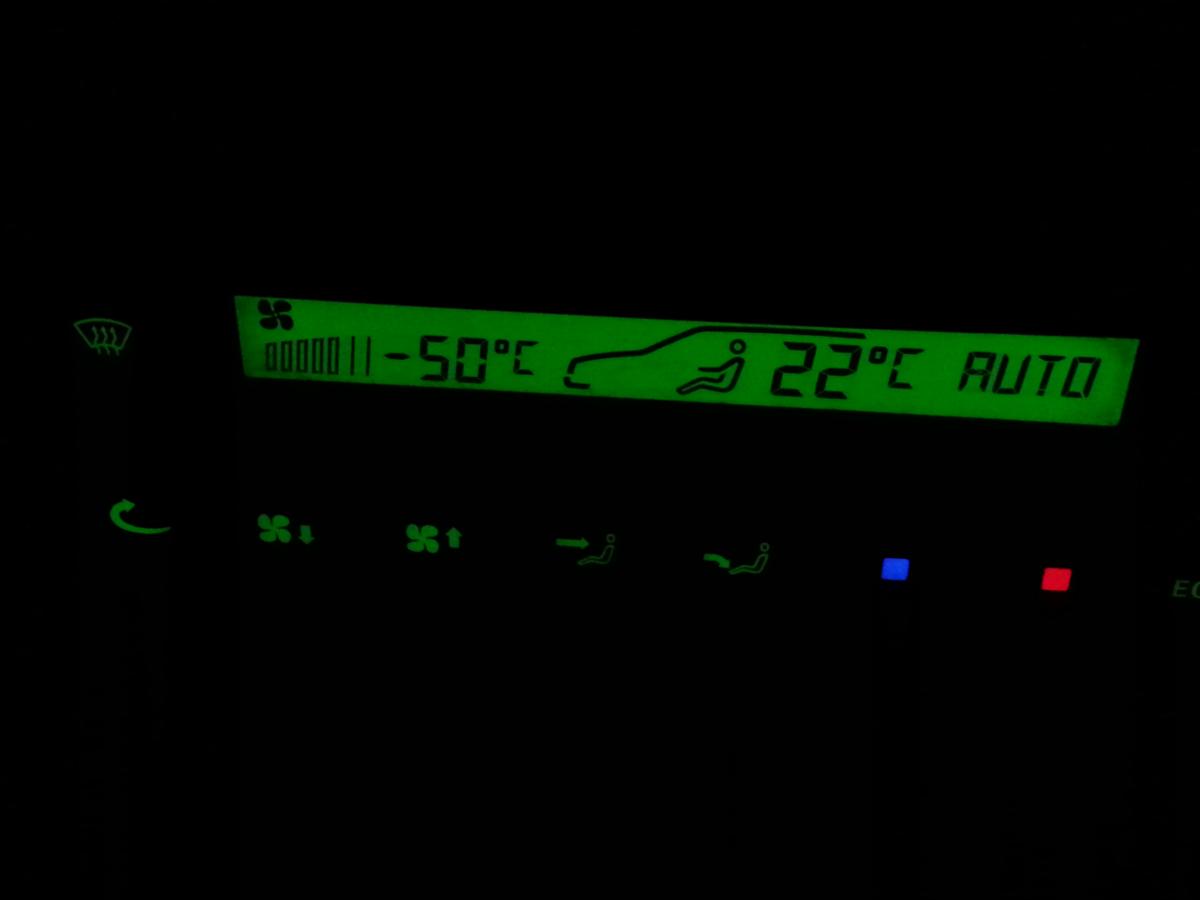

Today it was raining very hard and when I started my Octi and turned ON the AirCon, the temperature suddenly started to decrease from 29 degrees to -50 degree Celsius, that too without any cooling and within 5 secs.
This happened earlier as as well, but at that time if got fixed itself after driving the car for 1kms.
I tired almost every thing, like ECON mode, turned heater ON for good 6-7 kms but the temp is stuck at -50 degrees.
Please suggest how to fix this?
I have attached the pics for your reference...
That's the outside temperature display, the sensor is behind the passenger side lower radiator grill. Quiet a common failure, sensor needs replacement.
 Minus  50.... chilly on the jiggly bits!!!!
I'd be reckoning same as manny - knackered temp gauge.
Lol… it was showing -50 and I was sweating like anything… actual temp outside was around 30 degrees.
Took car to a mechanic and found that temp sensor somehow got detached from the holder behind the bumper and was hanging…
Used compressed air to clean it and it worked :)
