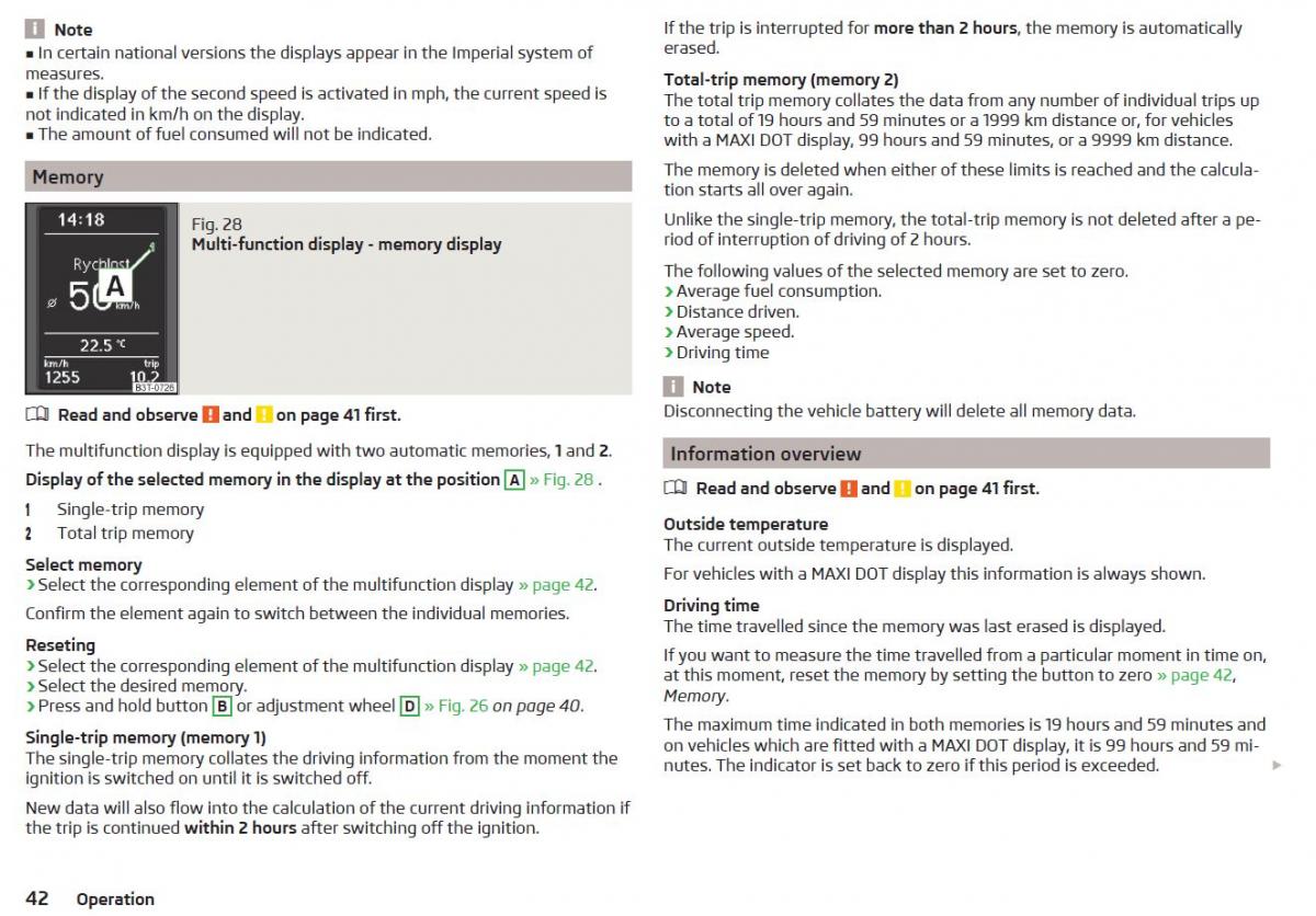

The MFD has two memories, one keeps the settings until reset by the driver, the other resets after 2 hours...
Wow, thanks, didnt know that!
This forum is awsome ;)
Guess I'll have to read the manual more carefully.
You will be surprised what you don't know yet. I have had mine for just over two years and was irritated that every time I set the Sat Nav the MFD defaulted to showing the Sat Nav display when what I wanted was to continue seeing the Audio track display. Have recently discovered how easy it is to change back.
Every days a school day!
Thanks to your post and replies, I now realise that the short term info resets after two hours. I didn't find the info in my Tiguan manual, but it's clearly there in the Yeti manual.
Thanks!

Trip computer No 2 automatically resets to zero after 100 hours of driving.
