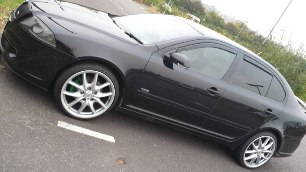

I'm at standard height and running 19s. My car is being lowered but is running at standard height. Look a lot better than my 18s did.post-115113-14119979360959_thumb.jpg

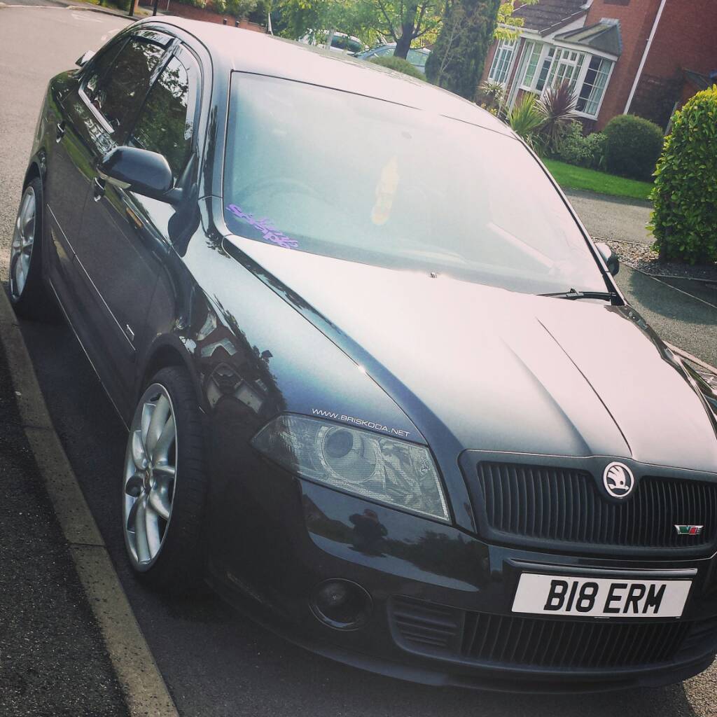

post-115113-14119979954178_thumb.jpg shows you the arch gap
Them wheels look nice a flush . what width and et are they pal ?
They are 9J, unsure on the offset to be honest. They are porsche so I'm running adapters to make fit
19" 9j et60. With 15mm adaptors take it to et45.
