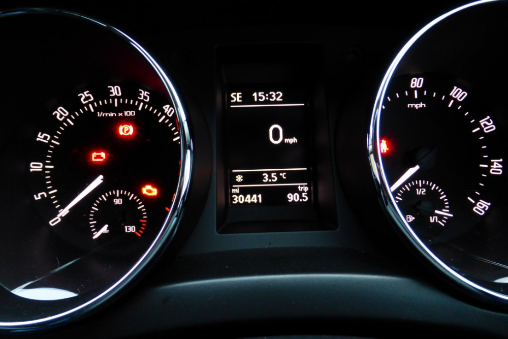

KB kindly activated my large mph display on my Octavia when he coded my Columbus last month and I can confirm it works perfectly and has not affected anything else!

The large Digital display can be turned off by maxidot to show the small KPH display if needed

It's a 10 second job to tick the "alt speed display" in the maxidot settings which puts back the km/h. Also by disabling the km/h option the info such as temp actually drops down into the line where km/h is shown, so you don't lose anything.

Once the mod has been done its easy to change back to Km/H by unticking a box in the Maxidot menu. As said in the many posts on this topic, the large digital speedo is so much easier to read at a glance than trying to see what the needle is pointing to, especially as 30 and 70 ain't on the dial. And with all these roadside speed displays you soon find 33 on the digital display = 30MPH whilst the analogue, due to paraliax error it could be reading anywhere between 25 and 35.
As above I have still got the external temp display, I think someone found that you can't display the instantaneous mpg display along with the large speedo,but that certainly didn't put me off as I never look at that as it pretty pointless, and you can scroll though to look at it if you really wanted.
