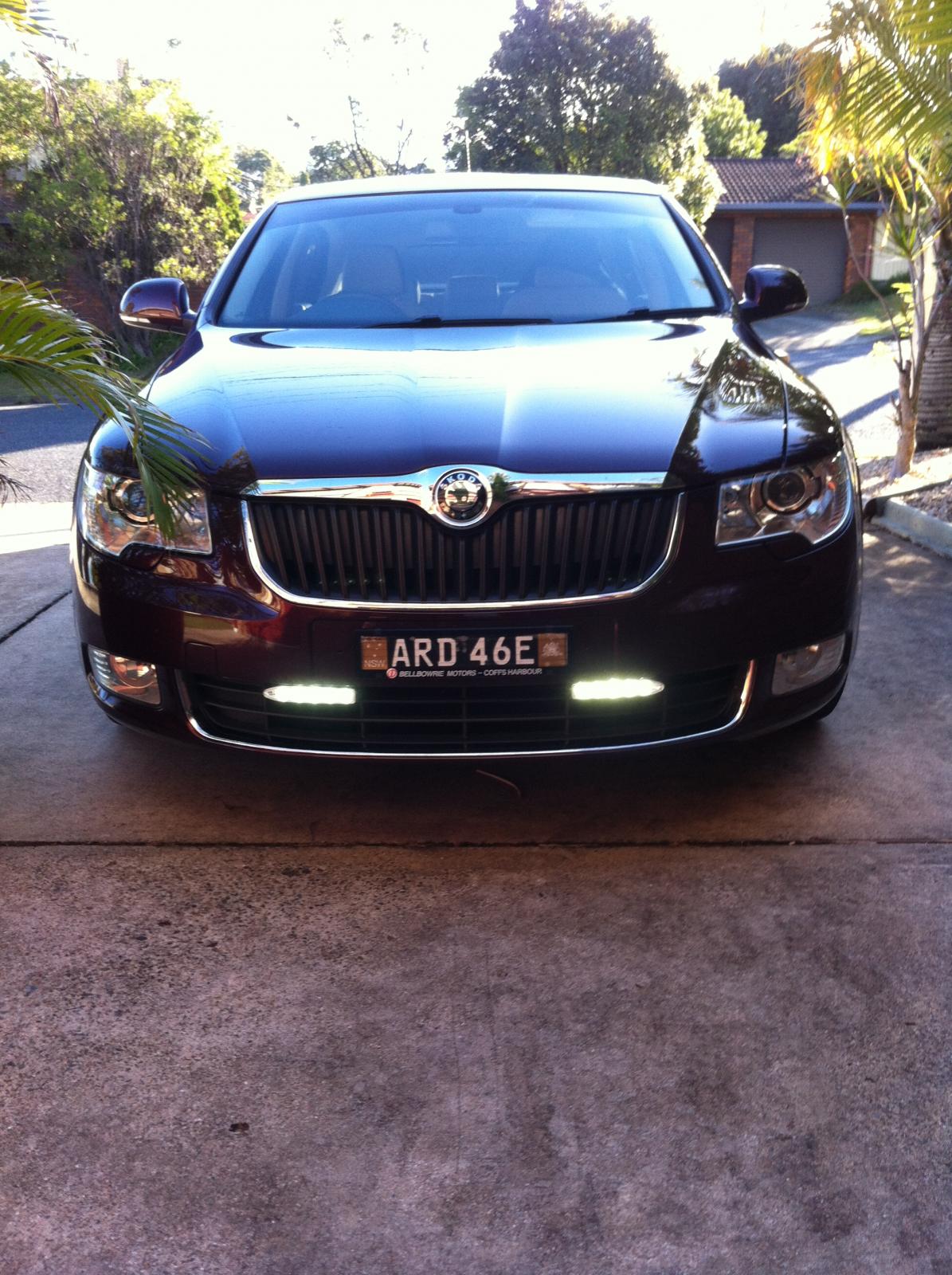

Not knowing about the gizmo you can buy to adapt the fog lights to DRL, I had an aftermarket LED set installed.  Wired so that they only operate when other head/park lights are off and when the ignition is turned off they remain on for 40 seconds which is handy at night looking for the  front door key!!
I've struggled with the upload of a photo and hope what I have done works!!
