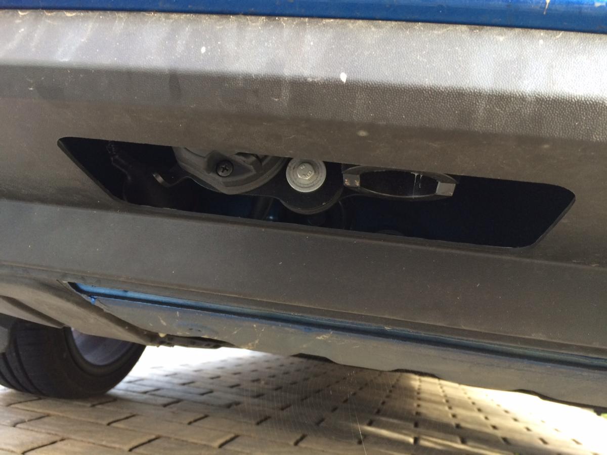

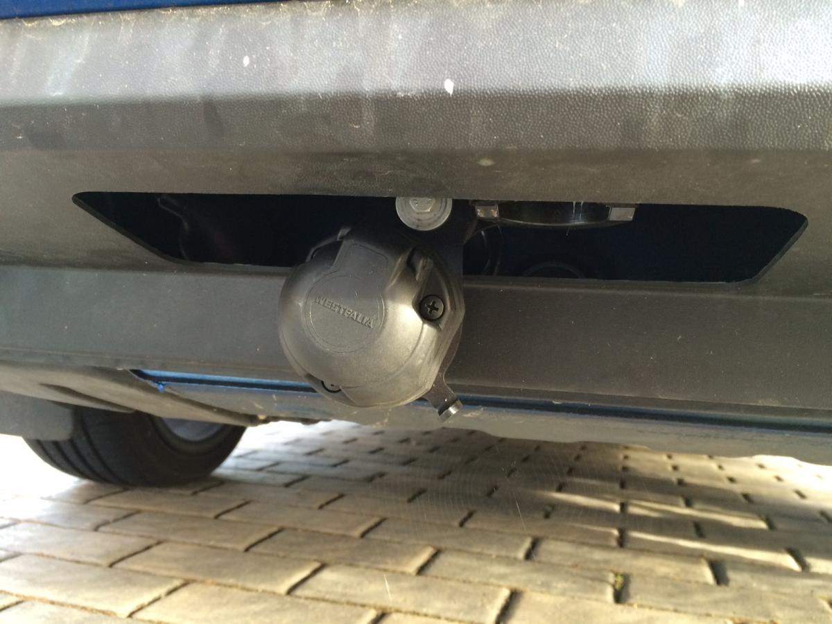

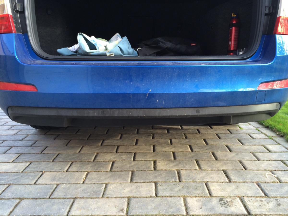

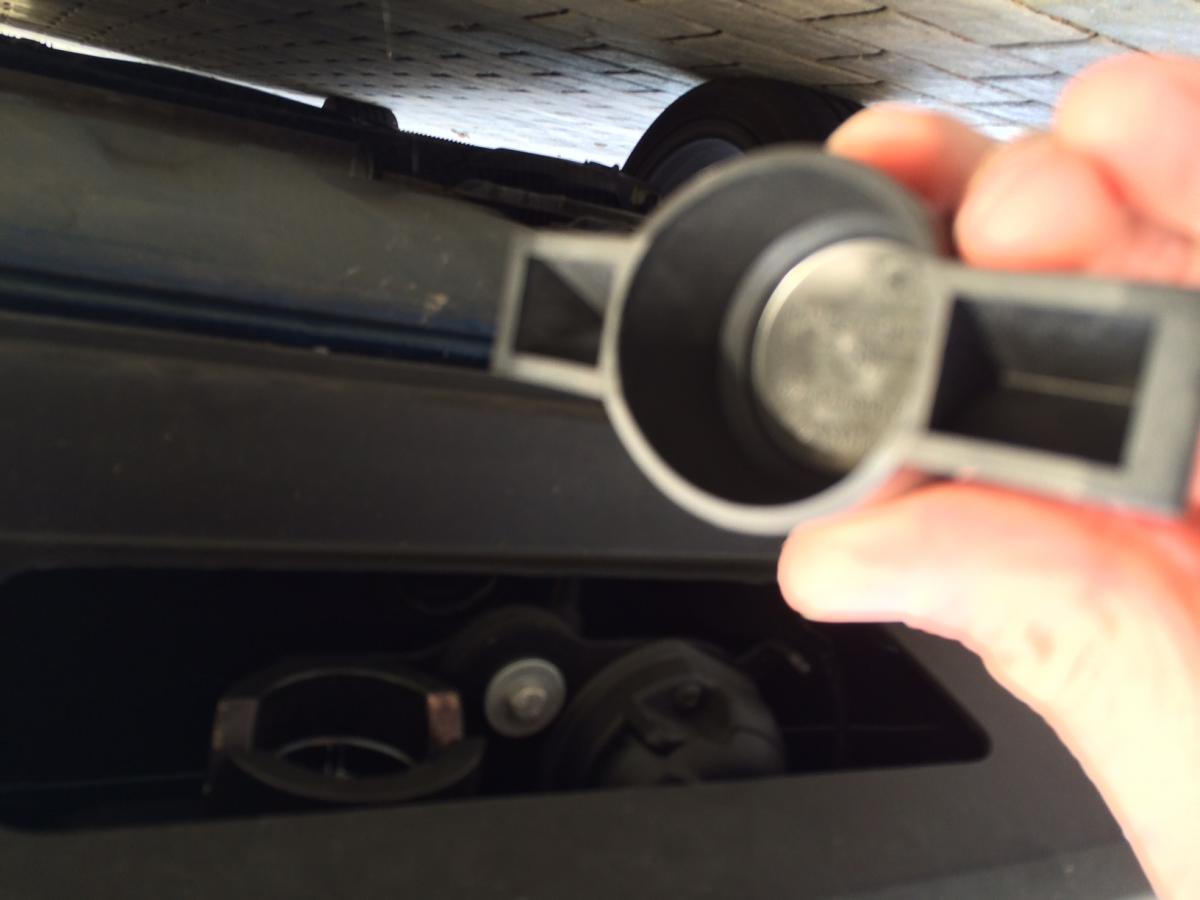

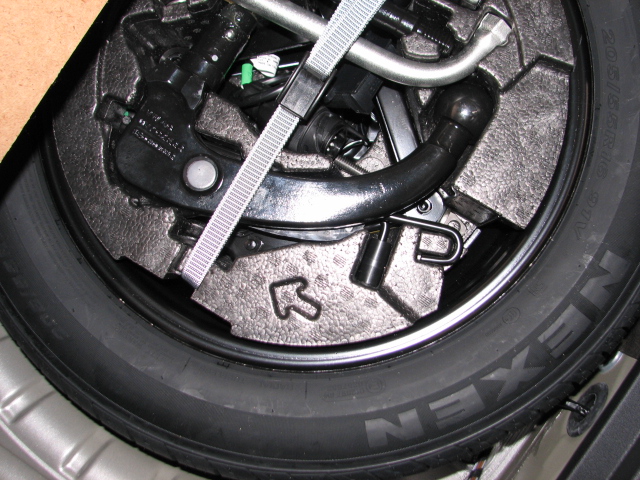

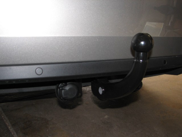

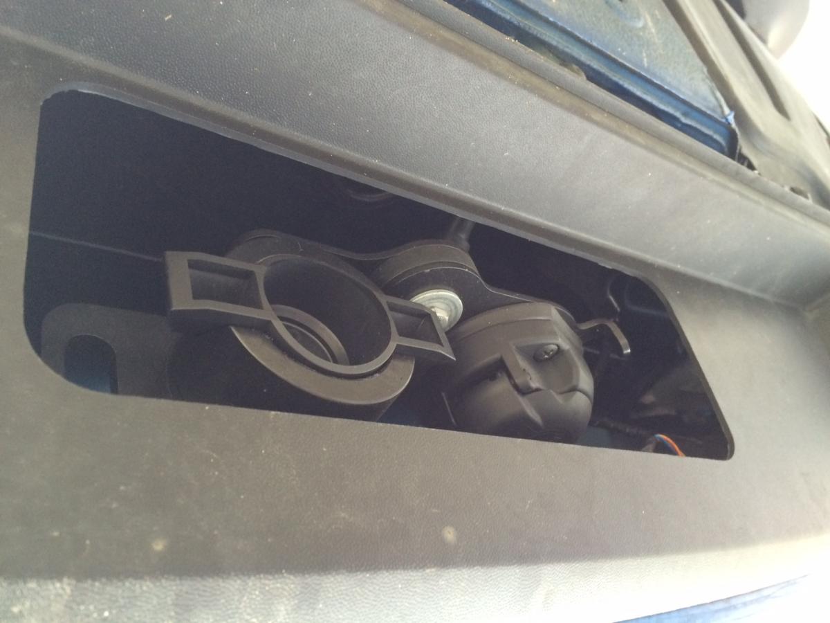

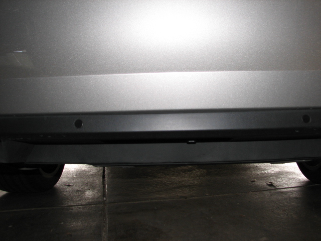

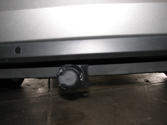

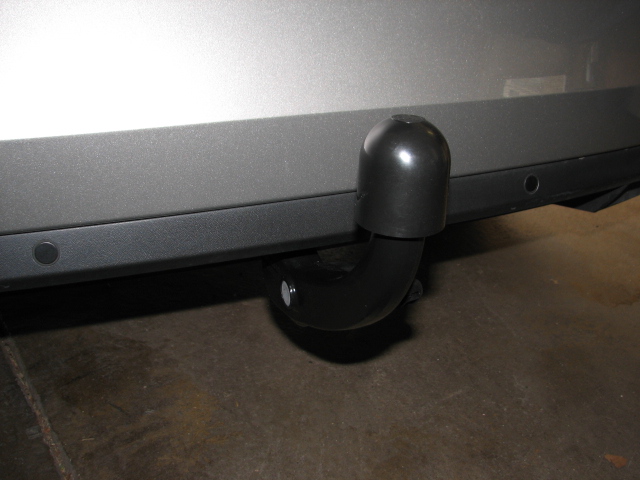

Slightly off topic but does anyone have any pix of the rear of the car with the removable towbar in place / removed?
Here is mine, as supplied by the Dealer in OZ.
post-93562-0-12689900-1414400289_thumb.jpgpost-93562-0-99134100-1414400304_thumb.jpgpost-93562-0-78854600-1414400323_thumb.jpgpost-93562-0-20263300-1414400332_thumb.jpgpost-93562-0-12604100-1414400344_thumb.jpgpost-93562-0-97928100-1414400353_thumb.jpg
Blimey, you really can't see anything when it's detached. Well impressive!
Is it the same on the VRS? The bumper is different, but how that would affect the towbar I have no idea.
The VRS is the same, no sign you have the towbar when detached. There is a little plastic cover to protect the socket and the electrics hinge up out of sight.

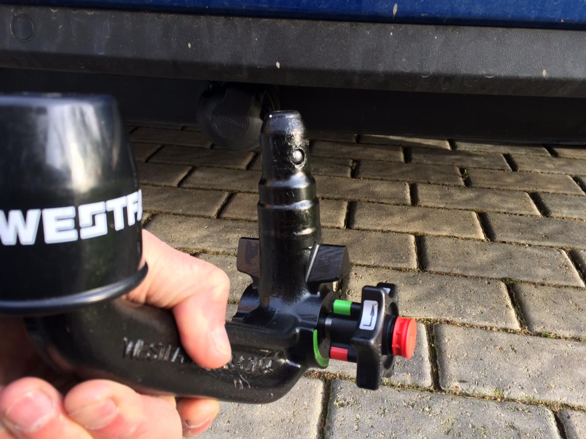

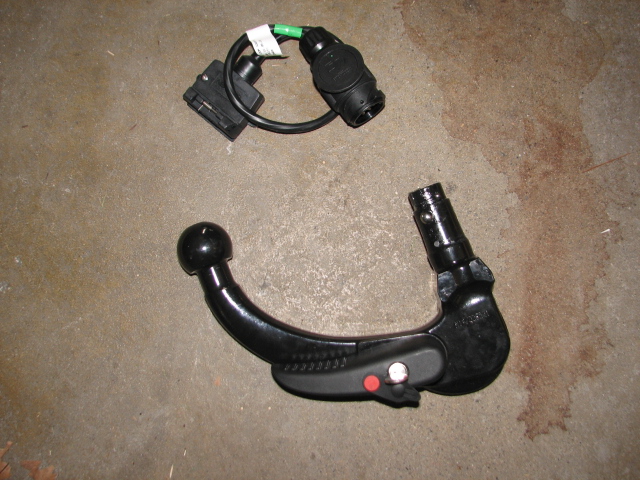

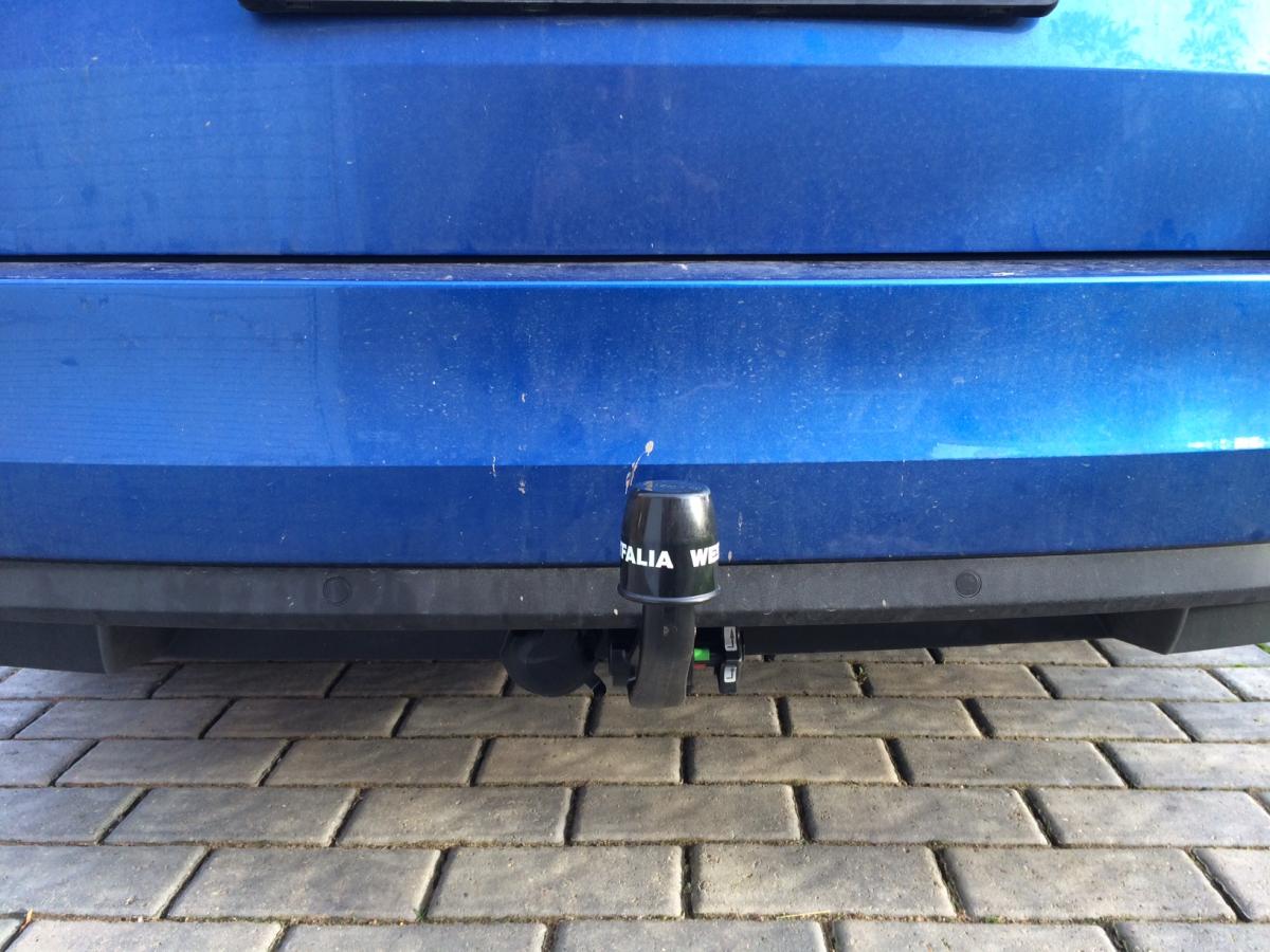

Here's a few before and after shots of my Westfalia Detachable Swan Neck (13 PIN).
Now ya see it...
