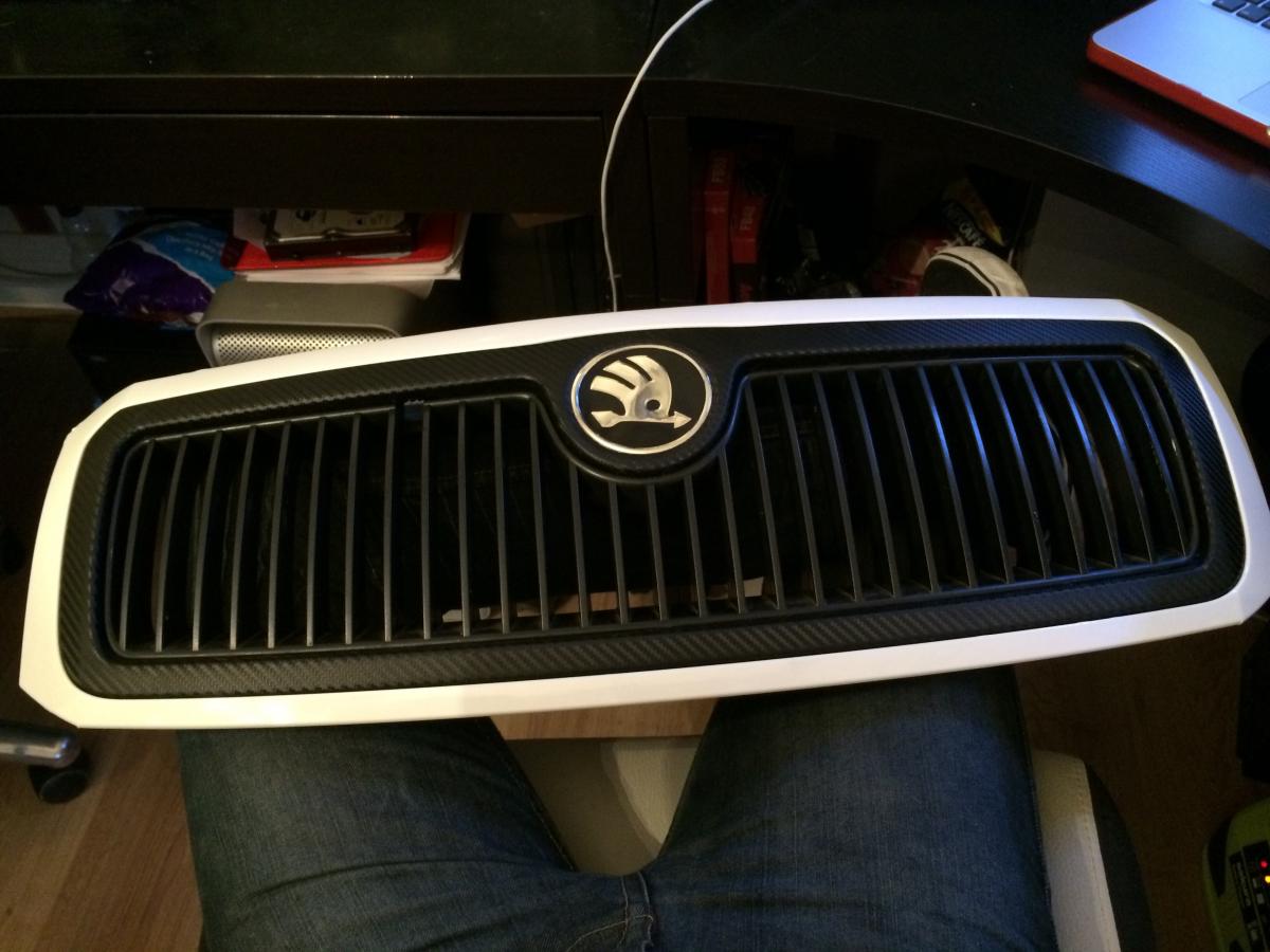

The first part of the car :) happy with the result
